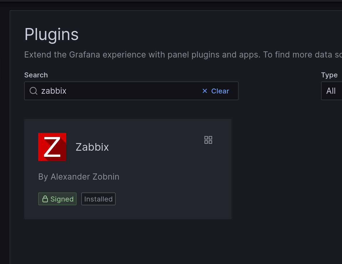

                      @Lanklan to restart the app , go to repair tab of the app and click on the restart button.
                      After that, I can see zabbix:

                          @girish said in Zabbix Plugin not found:
                          Already done it but i don't know why it's appared after several restart !
