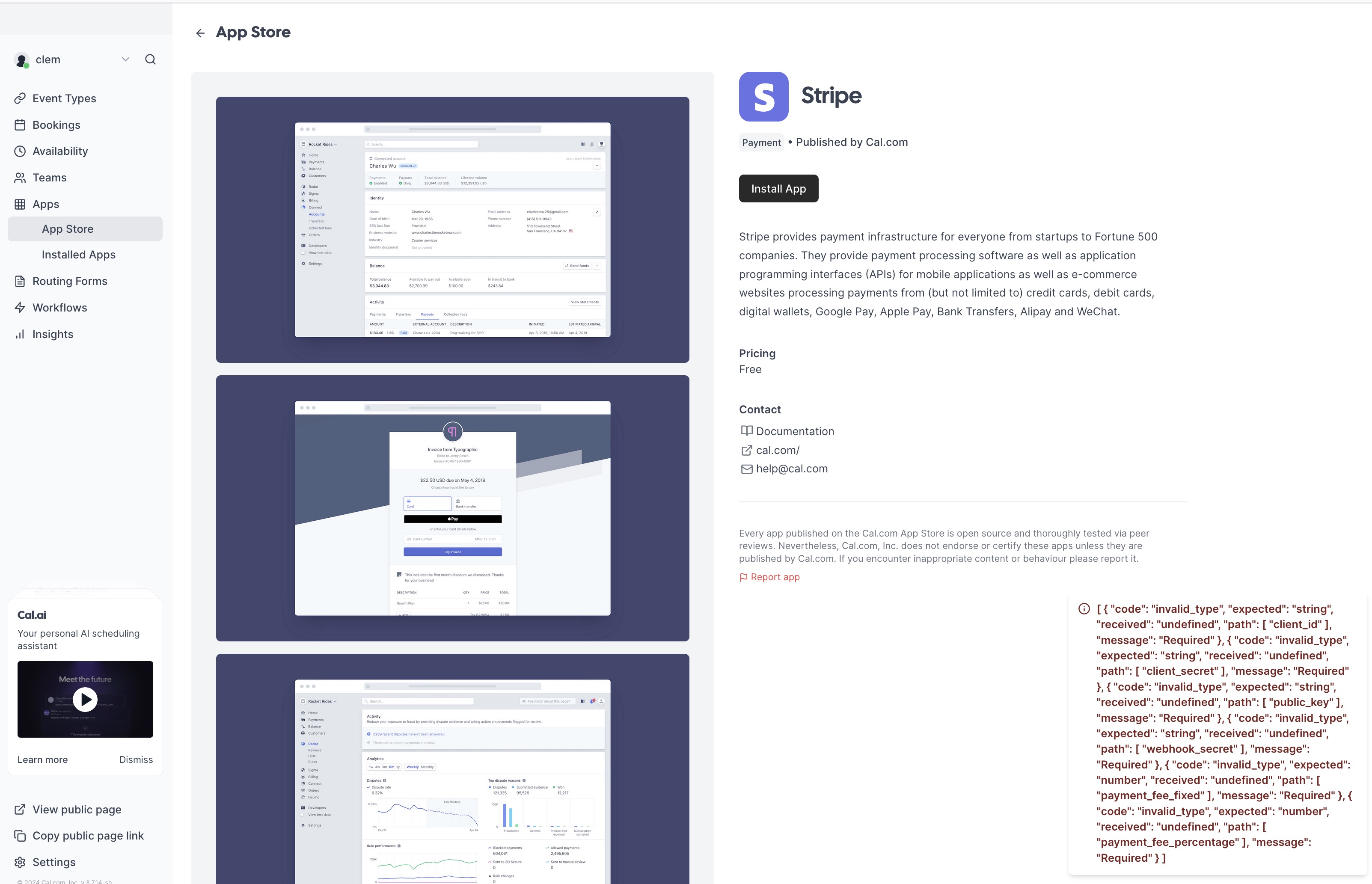

    Hello, after installing and configuring the environment variables, when I try to install the Stripe option in this Cloudron Cal app, I get this batch of errors:
    stripe error

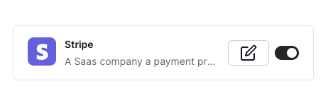

    Normally, the interface for adding the stripe option should look like this:
    alt text

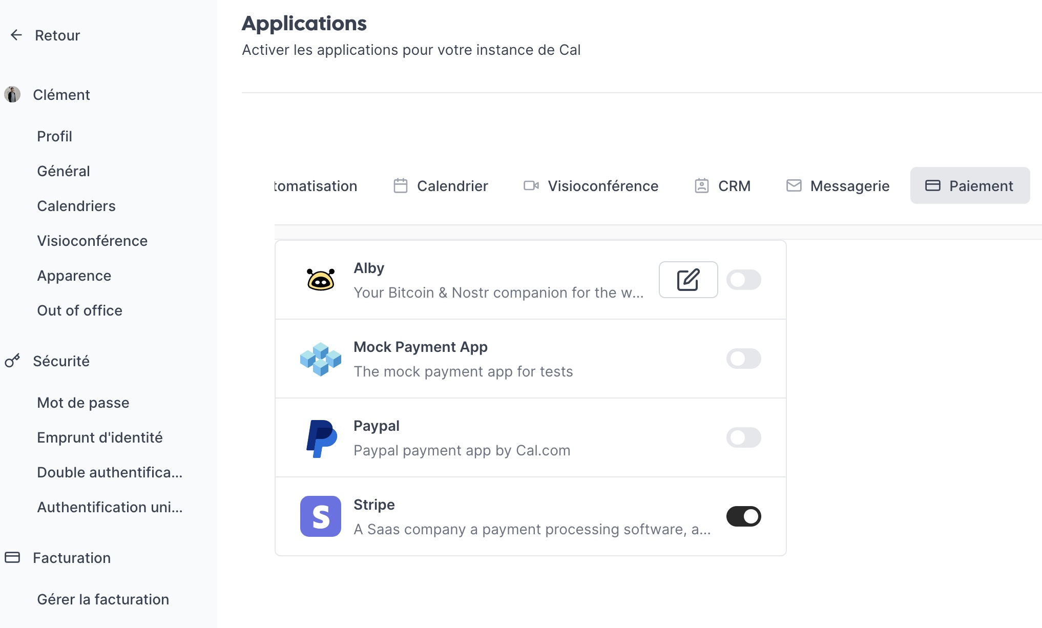

    But my interface looks like this, he edit button for entering variables is missing:
    alt text
    The configuration button is missing, which already seems to be a problem.
