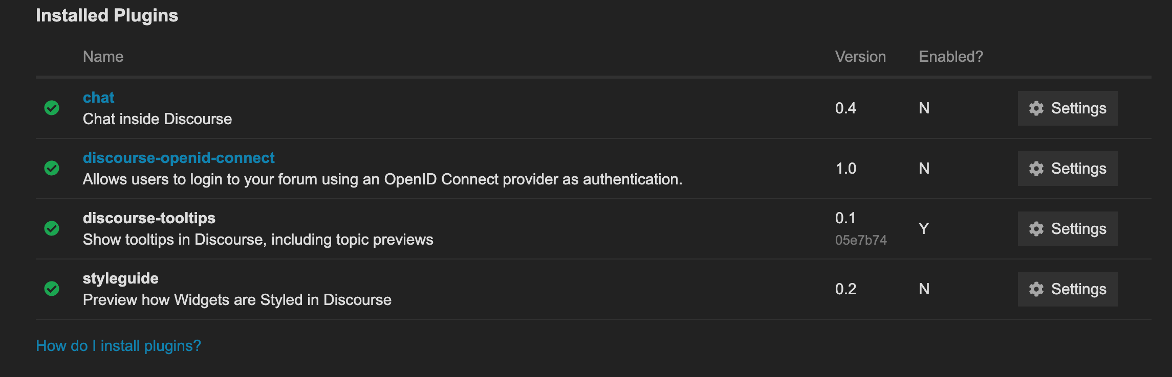

                        I have four plugins installed, but only one is active. Could an inactive plugin still cause issues?
                        • girishG Do not disturb
                          The main difference in 2.4.0 is that they put some ember based asset building . Maybe one or more plugins are incompatible. I don't know if inactive plugins can cause problems.

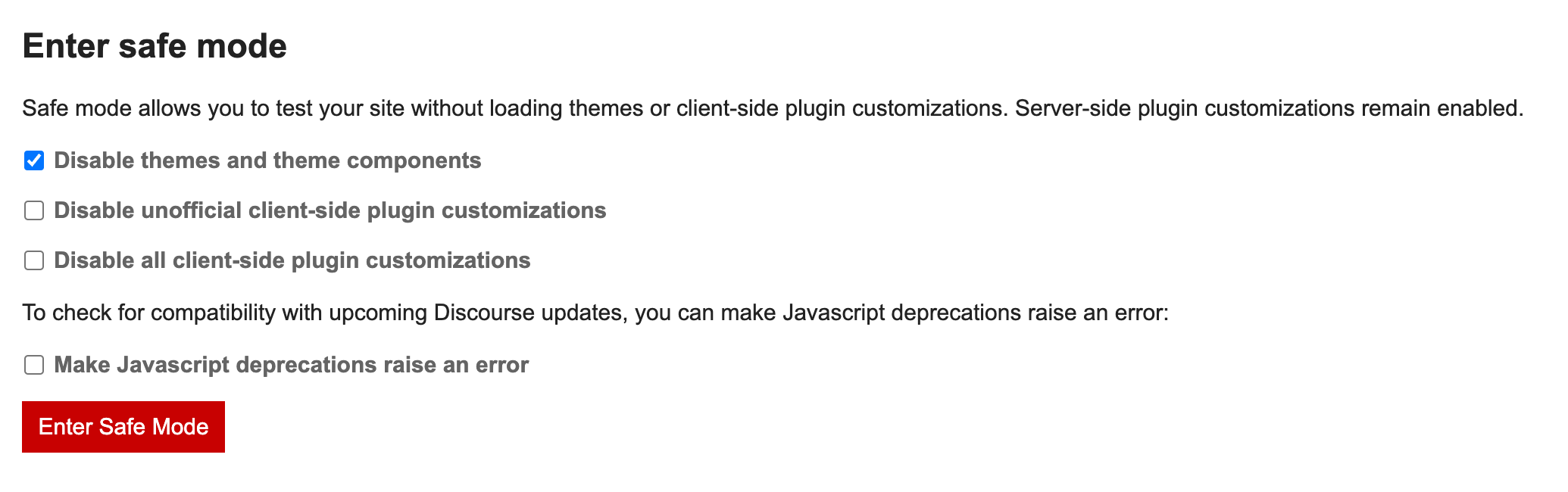

                            I just discovered Safe Mode, and that helped me narrow the source of the issue to either the theme and theme components that I'm using. Next step is tracking that down, but this helped considerably.
                            Wanted to share in case others run into the same issue! Visit <discourse_app>/safe-mode to toggle off three different potential sources of issues.

                              Next step was visiting /admin/customize/themes and checking for updates on the theme and each theme component. After installing all of the updates, I exited Safe Mode and visit in a new window. Discourse is accessible again!
