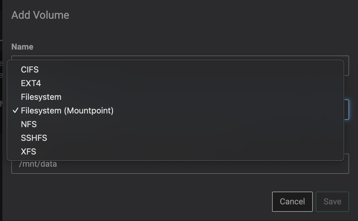

                @BrutalBirdie Hi, thanks. Already tried that nut doesn't seem to work...

                  ups...should have read the rest of the postings... so no chance to use the storage box for S3 via Minio?
                  • girishG
                    @sponch not on Cloudron atleast. I just checked the upstream project and they mention that there might be inconsistencies with using Minio with CIFS - this comment .
                    I did find this interesting series of articles about Minio+CIFS as well - https://maulana.id/soft-dev/2021--05--07--10--lesson-learned-on-deploying-minio-with-cifs-backend-part-1/ .... It's not straightforward.

                      Which mount type should i choose? (chatgpt says NFS or SSHFS but I am not sure)
                      • T
                        T
                        taowang
                        I just read the doc: https://docs.cloudron.io/volumes/
                        is CIFS the best option for hetzner storage box? since NFS is unencrypted, and SSHFS sub accounts are not very reliable>

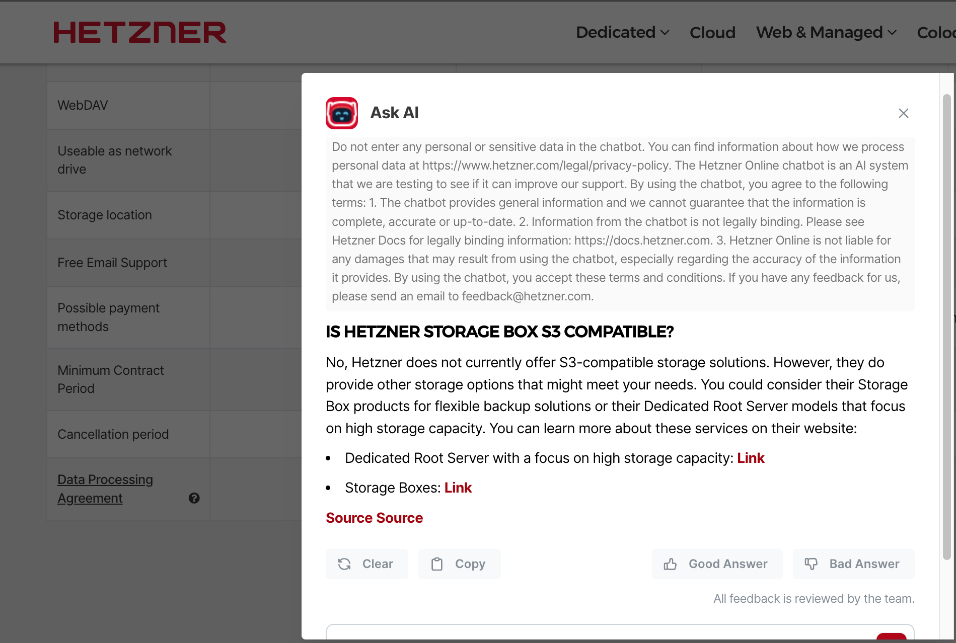

                                That works with object storage that meets 2 requirements: https://docs.joinpeertube.org/maintain/remote-storage
                                1. S3 compatible
                                2. support virtual hosting of bucket.
                                I thought Hetzner storage box is not S3 compatible. Is it?
