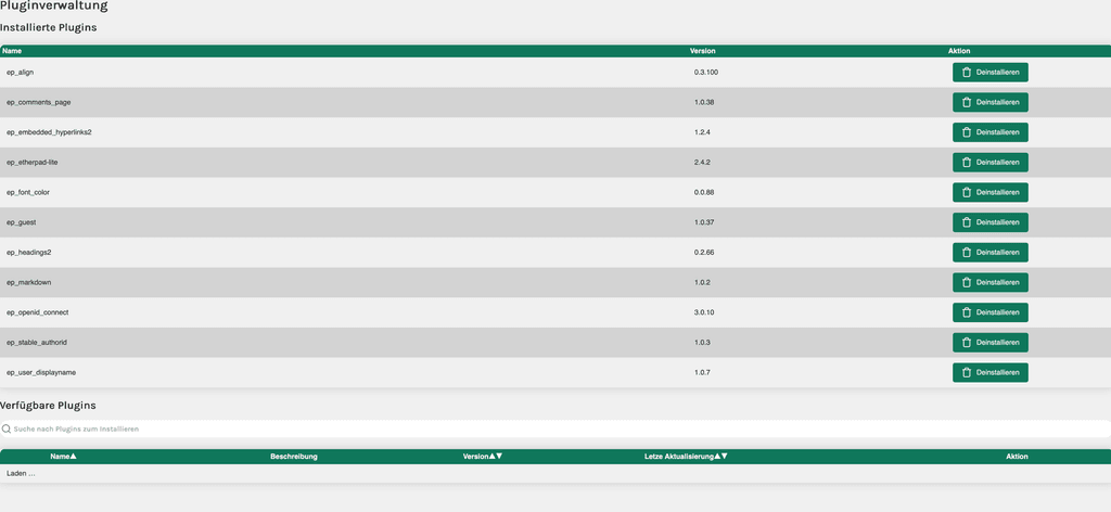

          New Updates new problems...as I couldn't remove the problems above I reinstalled the app from ground. No custom plugins. This worked finde (with each update) until the newest 4.4.0 / 4.4.1
          Ap can't start. There are no custom plugins installed only these (see screenshot) without any update information. Had to go back to 4.3.x
          same problem on 3 cloudron instances.
          any ideas??

                                    @sponch could you post content of /app/data/data/installed_plugins.json here?
                                    sponchS 1 Reply Last reply
                                    • vladimir.dV vladimir.d
                                      sponchS Offline
                                      sponchS Offline
                                      sponch
                                      #22
                                      @vladimir.d {"plugins":[{"name":"ep_align","version":"10.0.2"},{"name":"ep_comments_page","version":"1.0.38"},{"name":"ep_embedded_hyperlinks2","version":"1.2.4"},{"name":"ep_font_color","version":"0.0.89"},{"name":"ep_headings2","version":"0.2.68"},{"name":"ep_markdown","version":"1.0.1"},{"name":"ep_openid_connect","version":"3.0.13"},{"name":"ep_user_displayname","version":"1.0.7"},{"name":"ep_stable_authorid","version":"1.0.5"},{"name":"ep_guest","version":"1.0.37"},{"name":"ep_etherpad-lite","version":"2.2.6"}]}
                                      • vladimir.dV Offline
                                        vladimir.dV Offline
                                        vladimir.d
                                        #23
                                        @sponch could you try the following:
                                        1. create an app backup
                                        2. switch Recovery Mode on
                                        3. copy /app/data/data/installed_plugins.json to /app/data/data/installed_plugins.json.bkp
                                        4. update plugins versions by amending /app/data/data/installed_plugins.json as:
                                        {"plugins":[{"name":"ep_align","version":"10.0.2"},{"name":"ep_comments_page","version":"10.0.4"},{"name":"ep_embedded_hyperlinks2","version":"1.2.4"},{"name":"ep_font_color","version":"0.0.89"},{"name":"ep_headings2","version":"0.2.68"},{"name":"ep_markdown","version":"10.0.1"},{"name":"ep_openid_connect","version":"3.0.13"},{"name":"ep_user_displayname","version":"1.0.7"},{"name":"ep_stable_authorid","version":"1.0.5"},{"name":"ep_guest","version":"1.0.37"},{"name":"ep_etherpad-lite","version":"2.2.6"}]}
                                        1. delete /run/etherpad-lite
                                        2. switch Recovery Mode off
                                        If the app doesn't get running, please post the app log.
