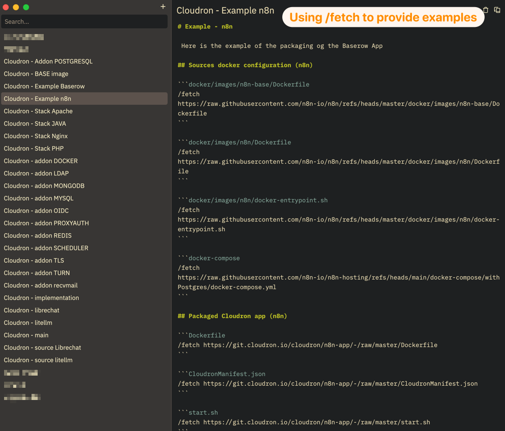

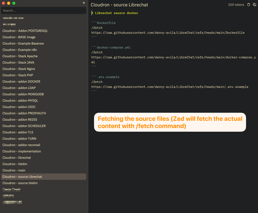

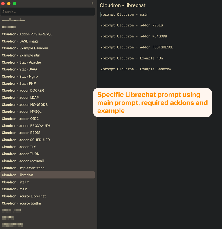

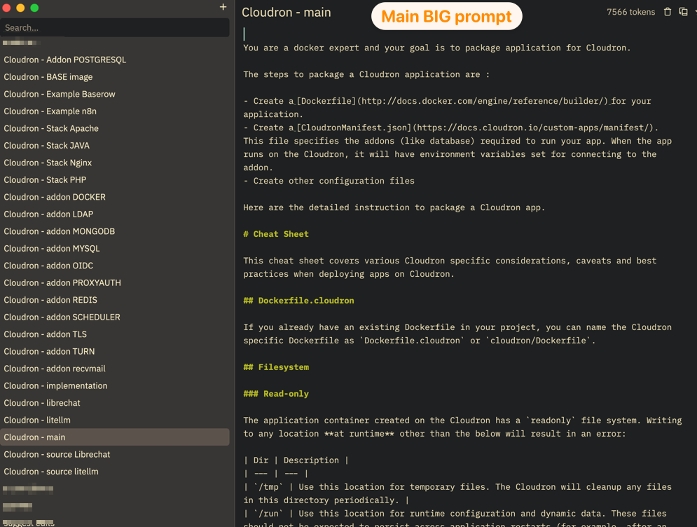

                          For those who want to dig "AI assisted packaging", here is how I proceeded
                          • I use Zed Editor which has a nice prompt library tool allowing prompt nesting (prompts in prompts. Sins Zed last "agentic" update, you need to use what they call "text thread" to have this feature/behaviour
                          • I have a main big prompt with all main specificities of packaging (Cloudron documentation mainly)
                          • I have smaller prompts about addon to be loaded only when needed
                          • And then I made specific prompts loading target app source files, and the same for example of packaged apps to guide the AI
                          I did this in 2024. This could be largely improved in 2025 with more agentic behaviour to let the AI fetch the context it needs 🙂
