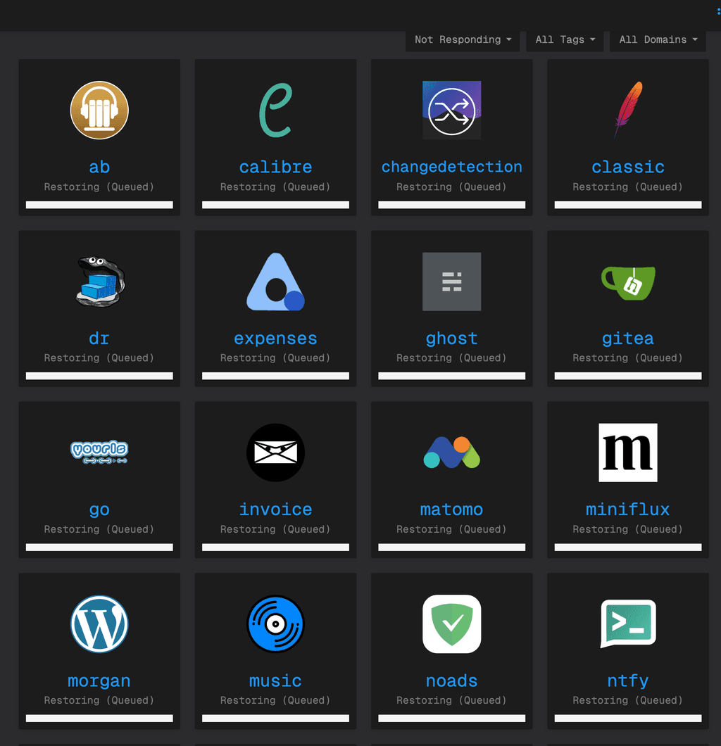

    • Apps restore are queued. So I know I have to point all apps DNS records to the new IP. As I'm using Hostinger, it's all manual, yet it's quick. But apps restore are still in queue.

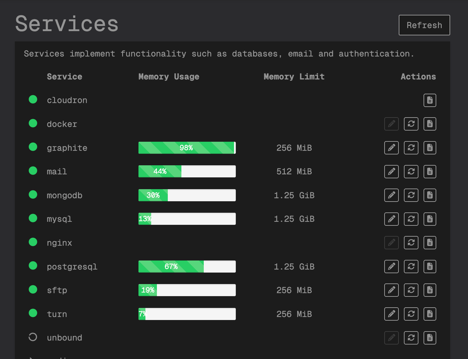

    I'm still stuck with :
    • sync dns failures.
    • certs renewal is failing fully or partially.
    • apps not restored so not available.
    • most of services are not in ready state.

      also for apps restore (still in progress)
    • Ok, after unblocking port 53, it seems now my apps are struggling to restore as DNS records pointing to IPV6 are expected, which i didn't provide. I'll fix the DNS setup to add the AAAA records pointing to the public ipv6.
    • Apps start to restore as expected after adding all the AAAA records pointing to IPV6.
