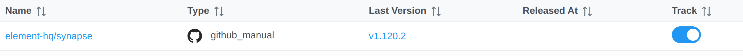

    I've added https://github.com/element-hq/synapse manually for the monitoring at 1.120.2 and it picked up no new releases ever since (and the latest is v1.128!)
    According to the logs, everything is synced Ok
    Apr 26 22:35:48 releasebell/tasks run: start +1h
    Apr 26 22:35:48 releasebell/tasks syncGithubStarredByUser: admin +4ms
    Apr 26 22:35:49 releasebell/tasks syncGithubStarredByUser: found 1 starred repos +244ms
    Apr 26 22:35:49 releasebell/tasks syncGithubStarredByUser: new projects: 0 outdated projects: 0 +4ms
    Apr 26 22:35:49 releasebell/tasks syncReleasesByProject: [element-hq/synapse] type github_manual start sync releases, notifications are enabled. Last successful sync was at 2025-04-26T19:35:48.572Z +15ms
    Apr 26 22:35:51 releasebell/tasks run: done. Next run in 3600s at Sat Apr 26 2025 21:35:51 GMT+0000 (Coordinated Universal Time) +6ms
    Apr 26 22:35:51 releasebell/tasks syncReleasesByProject: [element-hq/synapse] found 0 new releases +2s
    Apr 26 22:35:51 releasebell/tasks syncReleasesByProject: [element-hq/synapse] successfully synced +0ms
    Could you please, help with that?

            @nebulon looks like not...

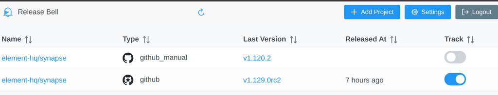

                  • potemkin_aiP
                    potemkin_aiP
                    potemkin_ai
                    Star based monitoring works!
                    I'm not using github stars, so I'm fine leaving with them - just one more question then: how do I remove a manually added entry?
                      Good question, seems like I didn't actually implement removal of those! Maybe I get around over the weekend, or otherwise PRs are welcome for that project 🙂
                      potemkin_aiP 1 Reply Last reply
