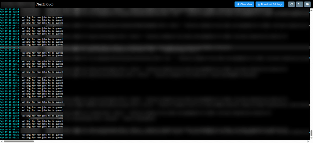

          Thanks for this improvement!
          I just updated our test environment and I can see those logs. Also, the time-reaction on AI assistant reduced as expected. Is there a way to set the -t parameter through the terminal? What was the value you used?
