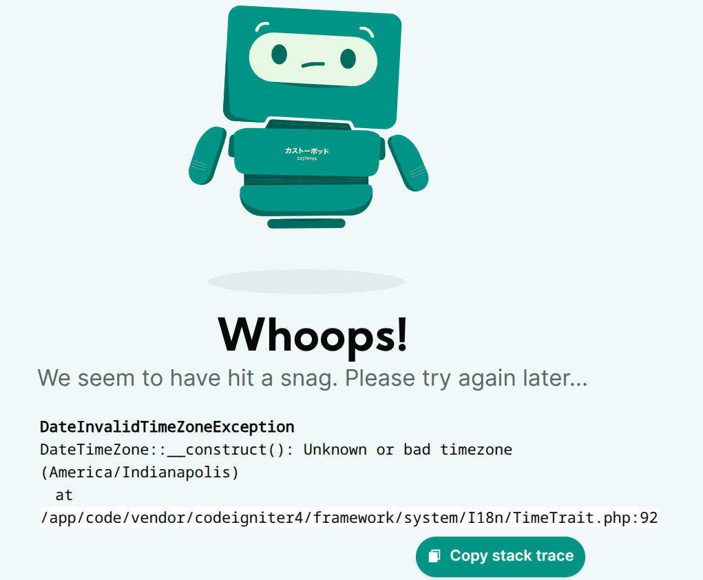

    I get this error when trying to a schedule a podcast episode (I deleted my city):
    DateInvalidTimeZoneException
    DateTimeZone::__construct(): Unknown or bad timezone (America/CityDeleted)
    at /app/code/vendor/codeigniter4/framework/system/I18n/TimeTrait.php:92
    When I copy the stack trace:
    DateInvalidTimeZoneException: DateTimeZone::__construct(): Unknown or bad timezone (America/CityDeleted) in /app/code/vendor/codeigniter4/framework/system/I18n/TimeTrait.php:92
    Stack trace:
    #0 /app/code/vendor/codeigniter4/framework/system/I18n/TimeTrait.php(92): DateTimeZone->__construct()
    #1 /app/code/vendor/codeigniter4/framework/system/I18n/TimeTrait.php(256): CodeIgniter\I18n\Time->__construct()
    #2 /app/code/modules/Admin/Controllers/EpisodeController.php(497): CodeIgniter\I18n\Time::createFromFormat()
    #3 /app/code/modules/Admin/Controllers/EpisodeController.php(64): Modules\Admin\Controllers\EpisodeController->attemptPublish()
    #4 /app/code/vendor/codeigniter4/framework/system/CodeIgniter.php(932): Modules\Admin\Controllers\EpisodeController->_remap()
    #5 /app/code/vendor/codeigniter4/framework/system/CodeIgniter.php(509): CodeIgniter\CodeIgniter->runController()
    #6 /app/code/vendor/codeigniter4/framework/system/CodeIgniter.php(355): CodeIgniter\CodeIgniter->handleRequest()
    #7 /app/code/vendor/codeigniter4/framework/system/Boot.php(334): CodeIgniter\CodeIgniter->run()
    #8 /app/code/vendor/codeigniter4/framework/system/Boot.php(67): CodeIgniter\Boot::runCodeIgniter()
    #9 /app/code/public/index.php(61): CodeIgniter\Boot::bootWeb()
    #10 {main}
    This happens both on the Cloudron demo server and my server.
    Is this an upstream issue?

      I did a comparison what timezone on Linux exist for America and compared them to the list of supported timezones in https://www.php.net/manual/en/timezones.america.php
      Comparison can be found here: https://regex101.com/r/mXRK1J/1
      Not supported timezones are:
      America/Ensenada
      America/Fort_Wayne
      Setting my timezone to America/Fort_Wayne:
      timedatectl
      Local time: Mi 2025-05-28 02:04:21 EDT
      Universal time: Mi 2025-05-28 06:04:21 UTC
      RTC time: Mi 2025-05-28 06:04:20
      Time zone: America/Fort_Wayne (EDT, -0400)
      System clock synchronized: no
      NTP service: inactive
      RTC in local TZ: no
      In a Chrome based Browser running:
      console.log(Intl.DateTimeFormat().resolvedOptions().timeZone);
      America/Indianapolis
      Good America/Indianapolis is not on the list https://www.php.net/manual/en/timezones.america.php
      DateInvalidTimeZoneException: DateTimeZone::__construct(): Unknown or bad timezone (America/Indianapolis) in /app/code/vendor/codeigniter4/framework/system/I18n/TimeTrait.php:92
      Stack trace:
      #2 /app/code/modules/Admin/Controllers/PodcastController.php(697): CodeIgniter\I18n\Time::createFromFormat()
      #3 /app/code/modules/Admin/Controllers/PodcastController.php(53): Modules\Admin\Controllers\PodcastController->attemptPublish()
      #4 /app/code/vendor/codeigniter4/framework/system/CodeIgniter.php(932): Modules\Admin\Controllers\PodcastController->_remap()
      #10 {main}
      This is the exact error you are having.
      Now in FireFox running:
      America/Indiana/Indianapolis
      America/Indiana/Indianapolis is on the list of supported timezone https://www.php.net/manual/en/timezones.america.php
      And the scedule publish of castopod worked fine.
      Solution / Error explanation
      It seems your are using a Chrome based Browser on a Unix based system (macOS / Linux) and a Timezone that gets converted into a TimeZone that is not support by PHP.
      Quick Fix
      Use a different timezone that is more generic and check in the web console with:
      if the timezone returned is avaiable in https://www.php.net/manual/en/timezones.america.php
      What should be done in a perfect world
      An issue should be raised with PHP and the Chomerium based browser you are using about this specific issue and Timezone.
      Either PHP should support all timezone or the chrome based browser should convert it into a supported PHP version one like FireFox does.
      I hope this will solve your issue.

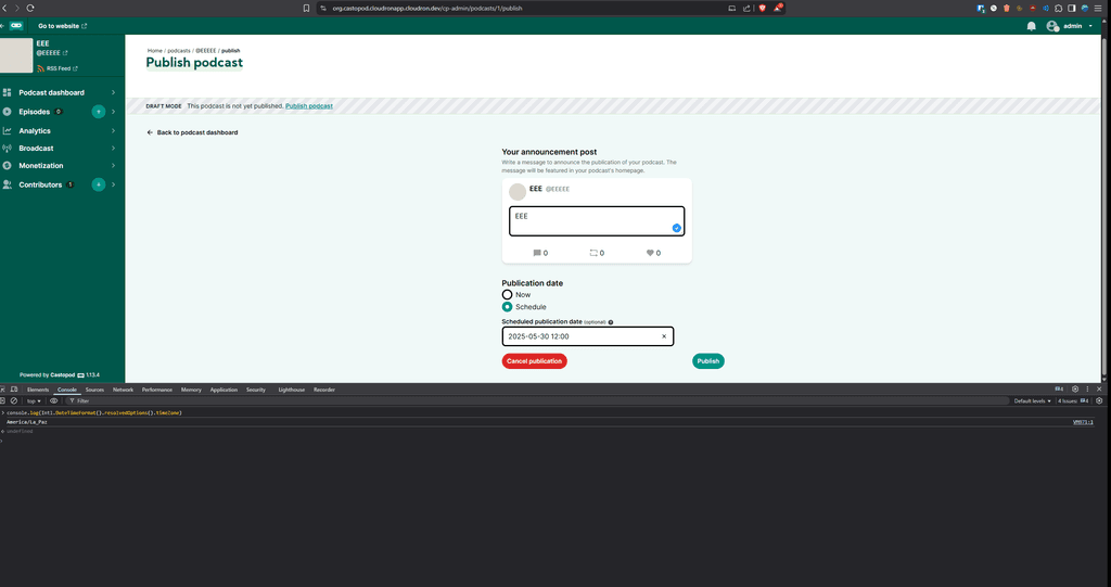

              After looking into the code of castopod I can see that the timezone is taken from the browser directly. There is no place to configure this, only on the local system level.
              Some testing:
              Windows 11, setting the Timezone to (UTC-04:00) Georgetown, La Paz, Manaus, San Juan since this timezone also includes a _ character for extra measure.
              In a Chrome based browser I validated the timezone in the console and tried to schedule publish a podcast.
              America/La_Paz
              May 28 01:45:58 2a02:8109:abb5:7100:a141:da1d:5d:6aa - - [28/May/2025:05:45:58 +0000] "POST /cp-admin/podcasts/1/publish HTTP/1.1" 303 - "https://org.castopod.cloudronapp.cloudron.dev/cp-admin/podcasts/1/publish" "Mozilla/5.0 (Windows NT 10.0; Win64; x64) AppleWebKit/537.36 (KHTML, like Gecko) Chrome/136.0.0.0 Safari/537.36"
              May 28 01:45:58 2a02:8109:abb5:7100:a141:da1d:5d:6aa - - [28/May/2025:05:45:58 +0000] "GET /cp-admin/podcasts/1 HTTP/1.1" 200 6432 "https://org.castopod.cloudronapp.cloudron.dev/cp-admin/podcasts/1/publish" "Mozilla/5.0 (Windows NT 10.0; Win64; x64) AppleWebKit/537.36 (KHTML, like Gecko) Chrome/136.0.0.0 Safari/537.36"
              May 28 01:45:58 2a02:8109:abb5:7100:a141:da1d:5d:6aa - - [28/May/2025:05:45:58 +0000] "GET /media/podcasts/EEEEE/cover_thumbnail.webp HTTP/1.1" 304 - "https://org.castopod.cloudronapp.cloudron.dev/cp-admin/podcasts/1" "Mozilla/5.0 (Windows NT 10.0; Win64; x64) AppleWebKit/537.36 (KHTML, like Gecko) Chrome/136.0.0.0 Safari/537.36"
              May 28 01:45:58 2a02:8109:abb5:7100:a141:da1d:5d:6aa - - [28/May/2025:05:45:58 +0000] "GET /themes/colors HTTP/1.1" 200 588 "https://org.castopod.cloudronapp.cloudron.dev/cp-admin/podcasts/1" "Mozilla/5.0 (Windows NT 10.0; Win64; x64) AppleWebKit/537.36 (KHTML, like Gecko) Chrome/136.0.0.0 Safari/537.36"
              May 28 01:45:58 2a02:8109:abb5:7100:a141:da1d:5d:6aa - - [28/May/2025:05:45:58 +0000] "GET /media/podcasts/EEEEE/cover_federation.png HTTP/1.1" 304 - "https://org.castopod.cloudronapp.cloudron.dev/cp-admin/podcasts/1" "Mozilla/5.0 (Windows NT 10.0; Win64; x64) AppleWebKit/537.36 (KHTML, like Gecko) Chrome/136.0.0.0 Safari/537.36"
              May 28 01:45:59 2a02:8109:abb5:7100:a141:da1d:5d:6aa - - [28/May/2025:05:45:59 +0000] "GET /manifest.webmanifest HTTP/1.1" 200 545 "https://org.castopod.cloudronapp.cloudron.dev/cp-admin/podcasts/1" "Mozilla/5.0 (Windows NT 10.0; Win64; x64) AppleWebKit/537.36 (KHTML, like Gecko) Chrome/136.0.0.0 Safari/537.36"
              May 28 01:46:00 2a02:8109:abb5:7100:a141:da1d:5d:6aa - - [28/May/2025:05:46:00 +0000] "GET /sw.js HTTP/1.1" 200 1058 "https://org.castopod.cloudronapp.cloudron.dev/sw.js" "Mozilla/5.0 (Windows NT 10.0; Win64; x64) AppleWebKit/537.36 (KHTML, like Gecko) Chrome/136.0.0.0 Safari/537.36
              draft mode
              This podcast is scheduled for publication on Friday, May 30, 2025 at 12:00 PM
              This seems to be working.
                America/Ensenada
                America/Fort_Wayne
                timedatectl
                RTC in local TZ: no
                Stack trace:
                #10 {main}
                Quick Fix
