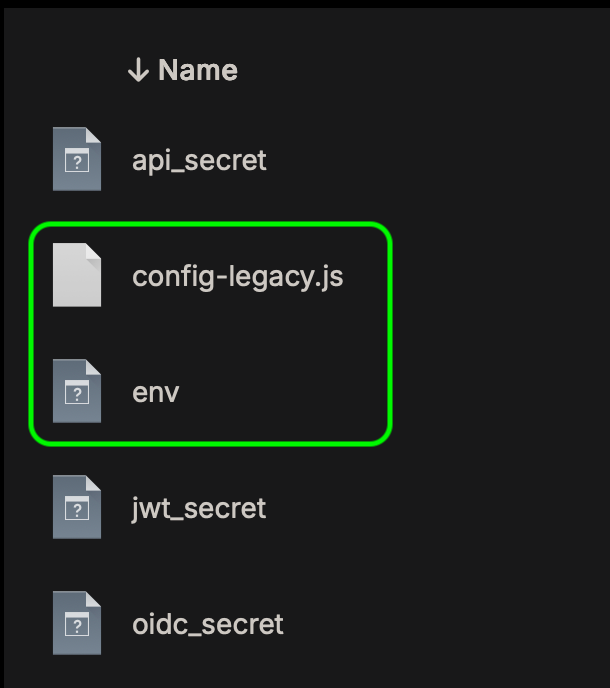

            One thing I have noticed since the update is that we now have access to 4 files from the file manager, three secret and the env file, but we don't have the config.js file which contains all defaults values so I can't see if there is something wrong there.
              This sentence leads me to believe that the update notice was not understood.
              From the update notice
              Package has moved to configuration via environment variables instead of config.js
              The old config.js file is saved as /app/data/config-legacy.js . You can view this using the File manager. Manually migration the settings into /app/data/env
              In other words:
              The config.js is no longer used.
              You will not find it or be able to configure anything via that file.
              If you wish to migrate these settings, we stored the file in /app/data/config-legacy.js.
              Please view and do all configuration in /app/data/env.

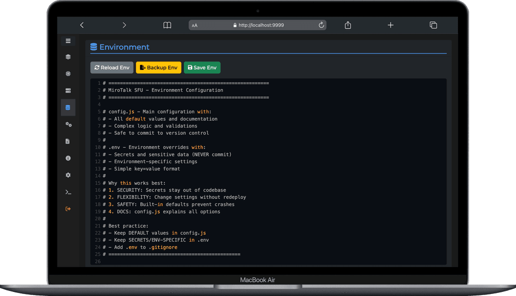

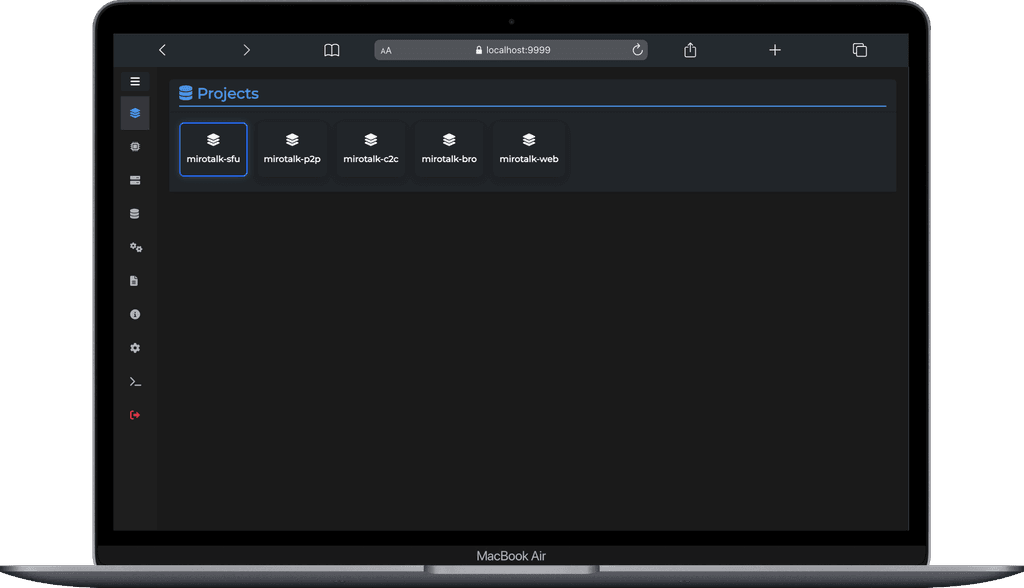

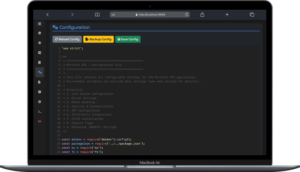

                          I recently created MiroTalk Admin, tailored specifically for MiroTalk projects (SFU/P2P/C2C/BRO/WEB). πŸ™‚
                          The Dashboard UI allows you to easily edit both the .env file and the config.js file as needed.
                          GitHub Repo: https://github.com/miroslavpejic85/mirotalk-admin

                            @MiroTalk Looks great! Actually I had just seen this earlier today in your discord channel! I didn't think it'd come handy that quickly for my use case though πŸ˜‰
                            I guess this will have to be packaged somehow so it integrates with the MiroTalk apps on Cloudron?

                              @avatar1024 said in Email as default username since update to new config set-up is NOT great πŸ™‚:
                              Thank you!
                              You can also use MiroTalk Admin directly from your local PC by adding your server’s SSH credentials to the .env file.
                              Then, simply edit the backend/config.index.js file (see the APP_CONFIG section) to configure it for MiroTalk SFU, or other variants.
                              I've been using it myself for several days to manage and update my demo instances β€” and so far, it's working great!

                                  I also have a self-hosted version of Cloudron. From what I can see, using the File Manager, you can edit both the .env and config.js files to tailor the setup to your needs.

                                    @MiroTalk said in Email as default username since update to new config set-up is NOT great πŸ™‚:
                                    You can see the config-lagacy.js because your instance was upgraded from a previous version. The file is there just so you can see your old config and migrate them using the env file, but the config-lagacy.js file itself is not used by the app. On a fresh install of the app this file is not there. Just as a test/try I have manually created a config.js file in that directory and added the lines you mentioned:
                                    oidc: {
                                        peer_name: {
                                            force: true,
                                            email: false, // --> set to false
                                            name: true, // --> display the user's name from OIDC instead of their email
                                    ...but this has no effect.
                                      OK, I think I understand the issue now. Cloudron retains the upstream config.js file as the default. To make changes, you're expected to use only the .env file. However, not all configuration options are currently supported there. For instance, setting the displayed username when OIDC is enabled can only be configured in config.js for now.
                                      To address the issue with the OIDC display name, I need to make it configurable via the .env file.
