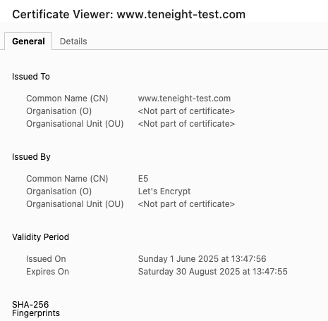

      Hello @leemuljadi
      You can always try to manually run the certificate update process => https://docs.cloudron.io/certificates/#renewal
      Using the main domain for a WordPress managed should be no issue.
      Could you inspect the certificate in the browser where it says Not Secure and share the inspect view of that certificate?

          leemuljadi
          @james
            @leemuljadi said in HTTPS:
            pointing the root domain to the wordpress
            Just a guess but note that www.example.com and example.com are different domains i.e in theory it is possible to have two separate websites . If this is your situation, you have to add a redirection - https://docs.cloudron.io/apps/#redirections
            L Offline
            L Offline
            leemuljadi
            @joseph
            I put the main location at www.example.com
            and alias at example.com
            any difference of alias from redirection?

                @leemuljadi
                Could it be that your local computer time is incorrect? This can also cause such issues.

                  @james local comp time is fine. how do I know it is not correct though?
                  Btw this issue still persist somehow, but when I tried to open it from incognito mode it's fine, so probably it's the browser cache.
                  Thanks for the help.
