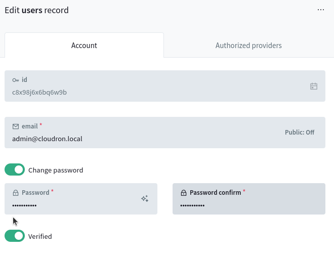

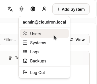

    Am I being stupid? I can't change the default password “changeme”. The change works in Pocket, and logging in there with the new password is no problem. However, even after restarting, Beszel only accepts the initial password. The Cloudron documentation is still empty, and the “First Time Usage” info after installation says that I should change the password, but not where.
      @simon a bit tricky that. looks like beszel is built on top of pocketbase.

        PocketBase accepts the password change. However, I can still log in to Beszel with “changeme” and NOT with the new password. Even after restarting Baszle.

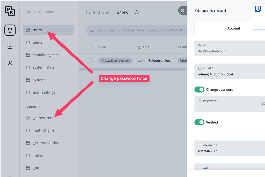

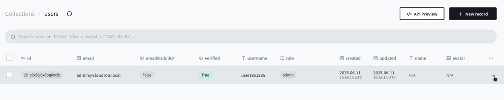

            I got it. You have to change the password in two places. In Users and in Superusers. The user with the same email address appears in both tables.
