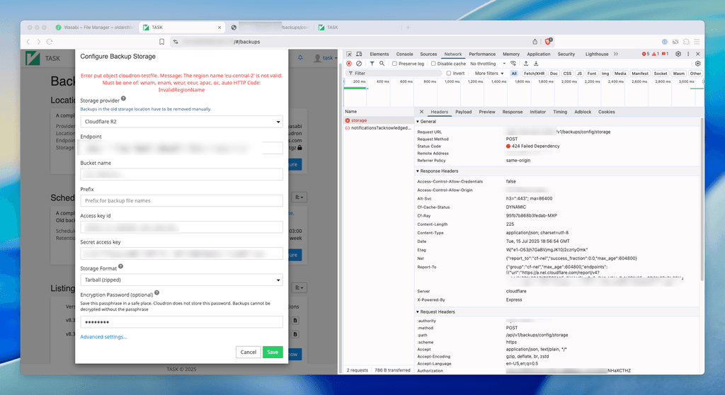

    Hello,
    We’re in the process of migrating our backup storage from Wasabi to Cloudflare R2. However, when adjusting the backup settings, we encountered the following error:
    Error: put object cloudron-testfile.
    Message: The region name 'eu-central-2' is not valid. Must be one of: wnam, enam, weur, eeur, apac, oc, auto
    HTTP Code: InvalidRegionName
    It seems the region value is still being taken from the previous Wasabi configuration.
    This is a screenshot for reference.
    Thank you in advance.

      I think this issue was reported in https://forum.cloudron.io/topic/13970/error-configuring-backup-cloudflare-r2-object-storage as well but we were unable to reproduce it.
      Can you try this quickly:
      • Change the backup to filesystem first. To /var/backup
      • Now, set up R2 again. Does this work? If not, can you give us access to debug further since we cannot reproduce on our end.

            @joseph Yes this solved the issue by changing to filesystem and then to Cloudflare R2
            but from wasabi to R2 there is an issue
            Thanks for your help
