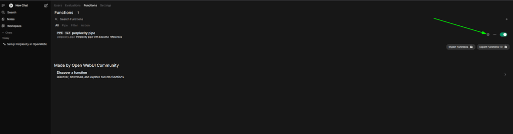

                  After some more research, I found for Perplexity a custom Function is needed.
                  A custom what?

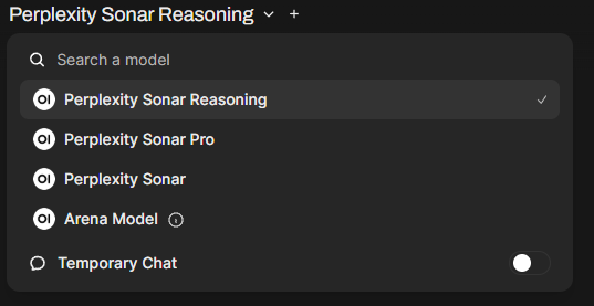

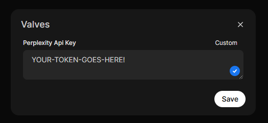

                  After even more search I found this: https://openwebui.com/f/neuromechanist/perplexity_pipe which I installed after a signup.
                  But you could also copy the code and add this function by hand.
                  After that I simply had to paste your API token:
                  Now I am able to select the modells:
