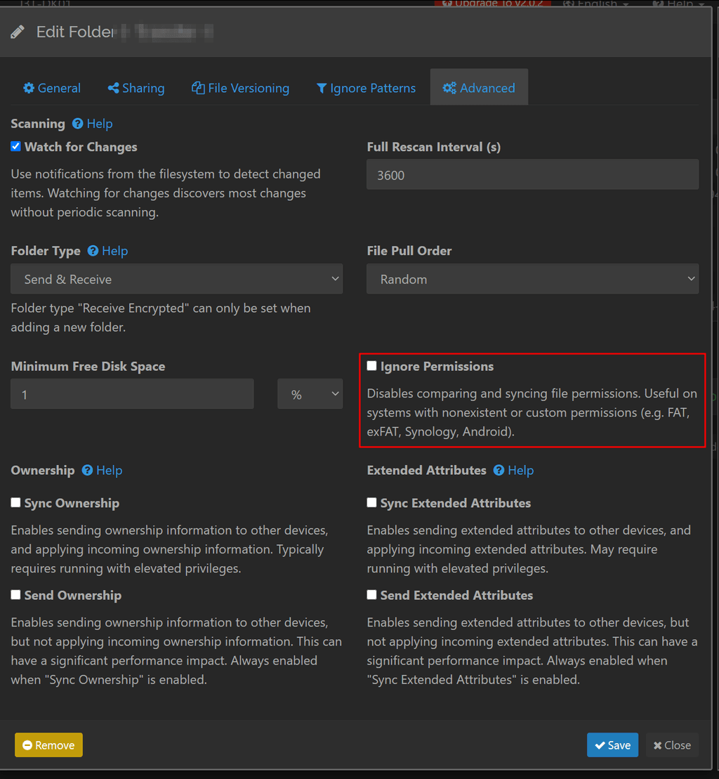

      @AartJansen What protocol are you using to mount your drive in Cloudron?
      You might want to look at the "ignore permissions" setting at the folder level in Syncthing to have things work properly.

        Thanks for the reply, yes I had stumbled onto that, and had set it. Didn't make a difference though.
        Have tried making the folder with the cloudron file/folder explore page, and via the sync thing share creation. The syncthing creation completely fails to create a folder.
