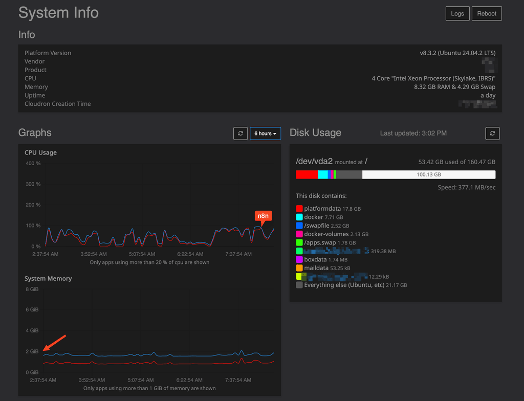

    I'm currently running an instance of Cloudron with n8n (version 1.107.4) and I'm trying to determine what the best configuration is for performance out of the box since I'm experiencing frequent issues, laggy interface and occasional connection timeouts.
    I have an instance with 4 vCPU + 8GB of RAM. By default, it looks like Cloudron allocates 256MB to Postgres and Redis.
    When I run a n8n app, I cannot get it to exceed 100% CPU out of 400% available CPU. The UI frequently locks up when processes are being run - and upon further investigation it looks like Postgres is being maxed.
    So I increased memory to 2GB for Postgres and Redis via the services panel in Cloudron. 2GB for Postgres was quickly filled and performance improved a little bit. But Redis use didn't change at all. I'm using whatever configuration n8n is set up for out of the box.
    I then pumped Postgres up to 4GB and its currently sitting at 70% again, performance seems to have improved a little bit but I cannot get n8n to use more than 100% CPU of 400%. I've confirmed at the VPS level that only 25% of the CPU is being used. Does anyone know how to get n8n to use more CPU? It is set to 100% in the Resource Panel.

      By default Cloudron does not restrict CPU usage per app (unless a limit is manually set). So presumably n8n itself is only single-threaded and thus only uses one CPU core at a time. This would mean you would have to increase the single-core performance of your server instead of adding more cores. This depends on the VPS provider in this case then and is likely not related to Cloudron as such.
      For redis, I am not sure how n8n uses redis and if that would improve your situation or if they use it for something which isn't your bottleneck.

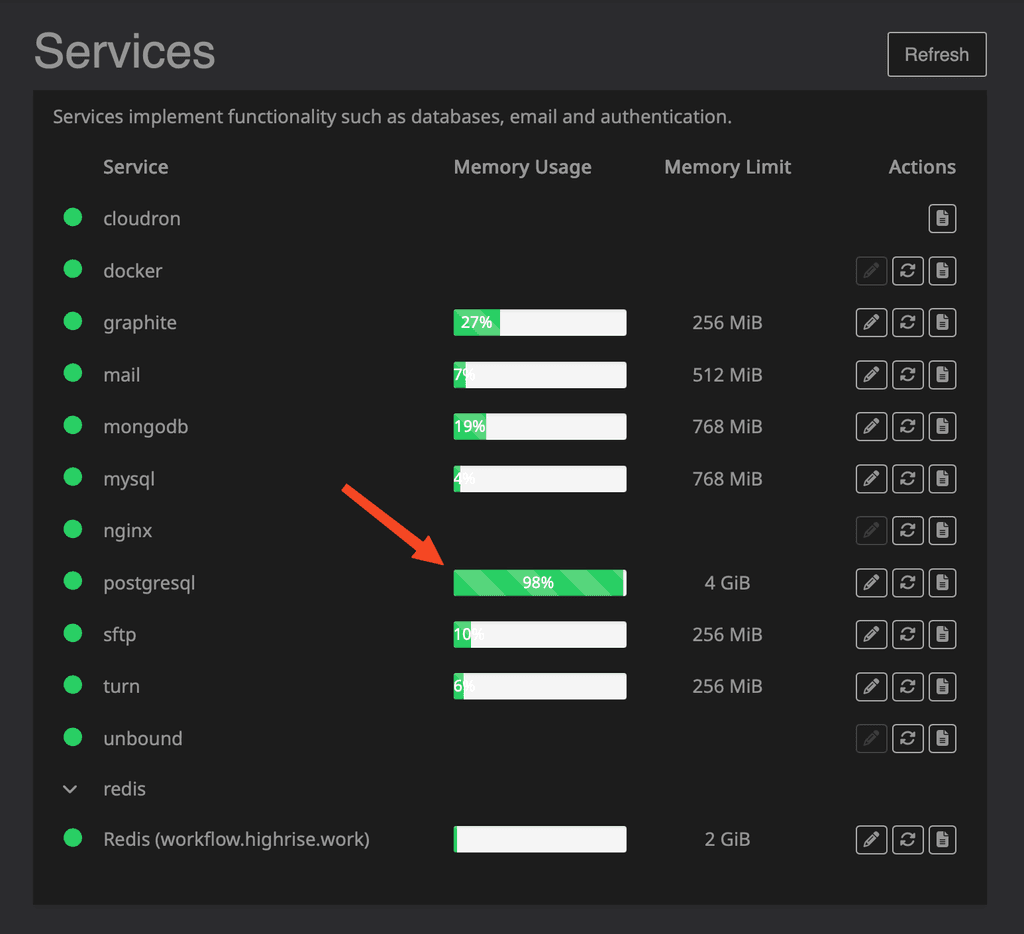

        Is it normal for Postgres to look like this all the time? It was like this at 256, 512, 1GB and now 4GB of RAM. The system information doesn't match the RAM allocation that's being reported.
          It is not unusual that the memory usage for a service like postgres is filled up. Generally if memory is available it is good to be utilized, however since a database engine doesn't know what else is on the system, we have that limit, otherwise it might just use up everything for caching.
