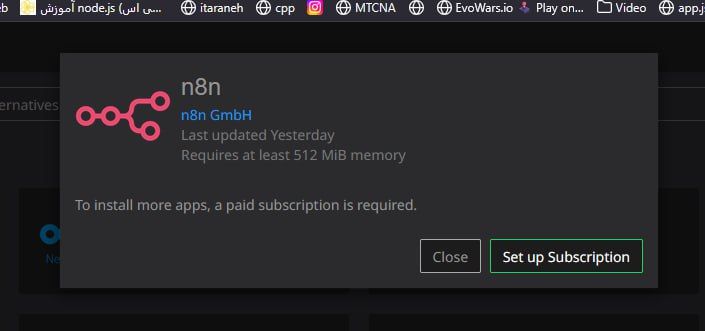

      I checked, its not allowing me to create more apps. I have total of 210 apps.
      Its interrupting our workflow. Could you kindly check this from your end?
      Thank you
        @arta Strange. I can confirm that the limit is 300 now and is deployed. What is the error message or error code you are getting? Are you using the API or the UI to install apps?
        • artaA Offline
          artaA Offline
          arta
          Hi,
          We are using the UI to create apps. Getting same error as I initially stated. The screenshot.

                @arta I sent you a mail now from support@ . Can you please check?
                  Should be resolved now. There were 2 limits, only one was bumped.

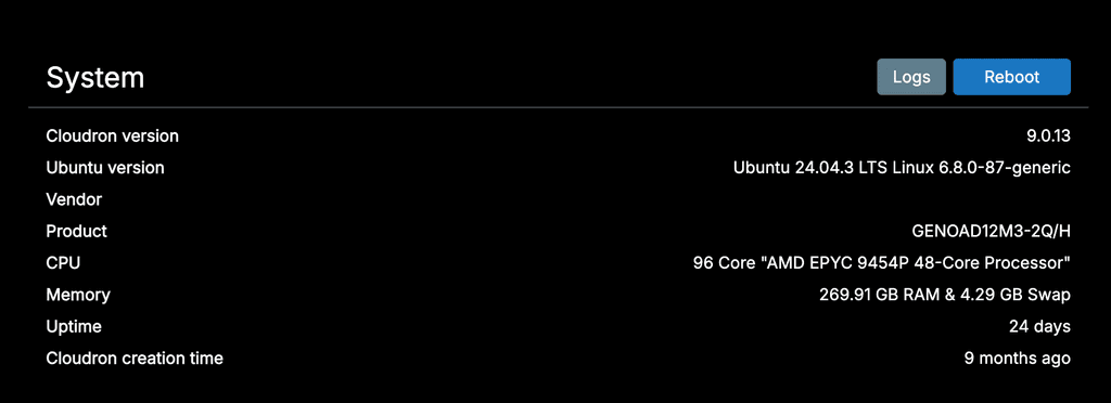

                                    @luckow I run cloudron on a dedicated server with this spec:
                                    We run lots of n8n instances. Also gitlab instances. We run a APP and Web development Company.
                                    Cloudron is our life saver as it makes keeping our projects easy. Specially deploying and backups. Its fast and a click away. FYI, we are almost close to 600.
                                    Thank you for your attention.

                                      @arta A quick follow-up question: How does it feel to restart or update the instance? Hopefully, everything will run as usual again after the task is complete. But the moment the screen goes black, all of the customers' applications are gone. Restoring a backup on another instance takes time. Really? Not for me 😉 Instead of using one large machine, I distribute apps and customers across different Cloudron instances. If one goes down, the others continue to run, and not all my customers call me at the same time.
                                      • artaA Offline
                                        artaA Offline
                                        arta
                                        #21
                                        You are not wrong in principle, distributing workloads reduces blast radius, and that approach makes perfect sense in many scenarios.
                                        Our setup, however, is slightly different. We operate our own colocation facility (4K rack capacity) with direct, hands-on access to the hardware. For this particular server, there is a live mirror in place with continuous rsync-based synchronization, so the data is always effectively warm. Internally, the servers are connected over a dedicated 10 Gbps private network. In practical terms, this means restoring or promoting a mirror is not a lengthy operation.
                                        It is also worth noting that these instances are not customer facing. They support our internal workflows, not production services for external clients, so the operational impact of a short outage is limited by design. Even in the worst case, an instance going down does not trigger customer downtime or a flood of support calls.
                                        The main reason we run Cloudron on a single server is automation. We rely heavily on the Cloudron API for provisioning, backups, restores, and lifecycle management, and keeping everything under one Cloudron instance allows these processes to remain fully automated and consistent. But sure, it has some costs.
                                        Running multiple Cloudron instances on separate servers would significantly increase operational complexity and require manual coordination, which defeats the purpose of our setup. Given our mirrored data, high-speed internal networking, and automated recovery, a single Cloudron control panel is a deliberate and acceptable trade-off for our use case.
