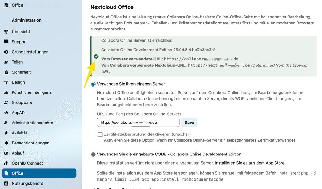

    the connection itself seems ok...

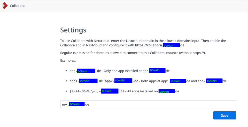

      What are the settings of the collabora app?
      I can see this screenshot is from Nextcloud.

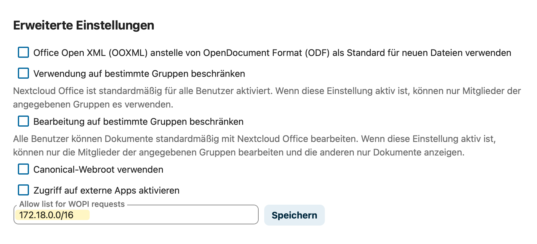

        looks ok:
          Hello @rstockm
          Since you censored your domain in the screenshots before, I took the liberty to re-consor you last screenshot, since you forgot to censor the domain name in the text above the input field.

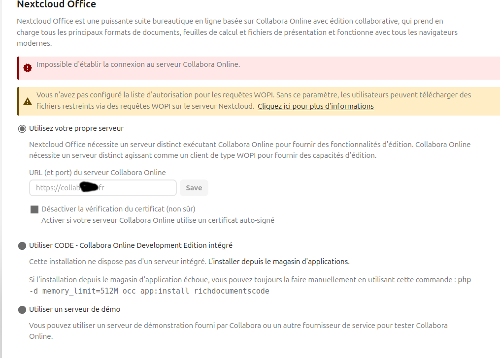

            I'm having similar problems since the upgrade to Nextcloud 32.
            And strangely, my settings for Nextcloud office are now greyed out, event though they retain the previoulsy functionning values.
