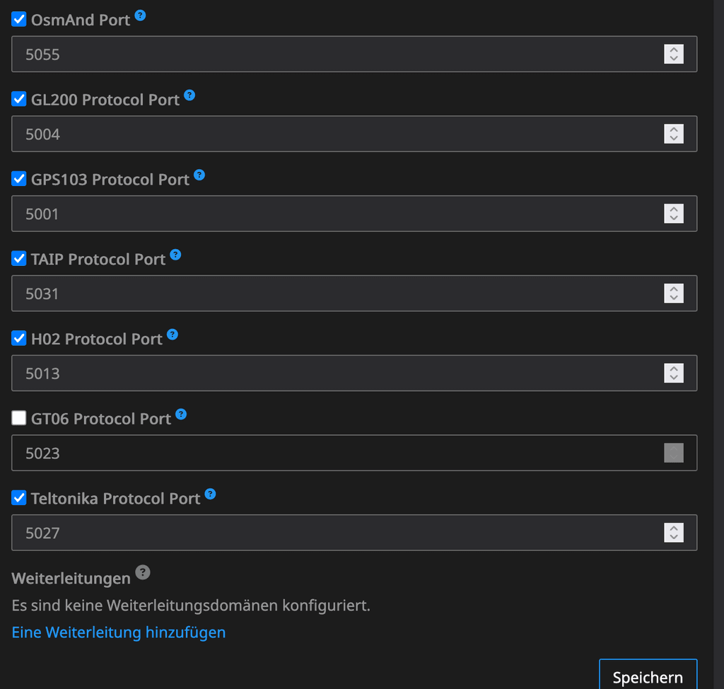

                  Have you enabled the port in the app configuration page after update?
                    Good point, I hadn't thought of that, but the port doesn't appear there either...
                    • girishG
                      The package requires Cloudron 9 . @rompo if you can drop us your domain name at support@cloudron.io , I can enable the Cloudron 9 update.
