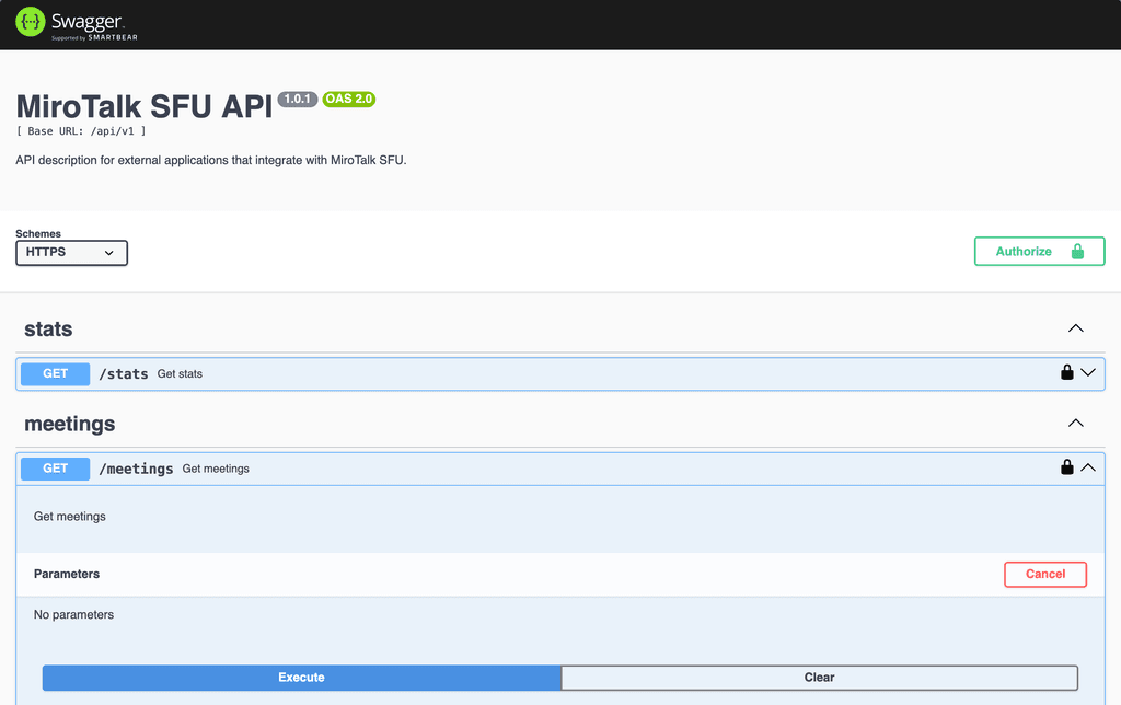

    In case this is useful to anyone else:
    I wanted to gain access to the full meetings and token APIs at my-server.com/api/v1/docs/:
    Since I was able to access the page above, it looked at first like everything was already set and ready to go!
    However, I soon learned that this was not the case:
    {"error":"This endpoint has been disabled. Please contact the administrator for further information."}
    This made me think that I needed to use the secret in /app/data/api_secret to access the API. But it didn't work (same error message as above).
    It turns out I needed to add the following to the /app/data/env file:
    API_ALLOW_MEETINGS=true
    API_ALLOW_TOKEN=true
    Once I restarted the server, I was rewarded with a new error!
    {"error":"Unauthorized!"}
    This unauthorized error shows up because, I believe, the /app/data/api_secret is not used for the meetings or token APIs. You need to ALSO add the following to your /app/data/env file:
    API_KEY_SECRET=yourVerySpecialSecret
    Finally, you can click the Authorize button in the swagger / MiroTalk SFU API page (shown above), and add yourVerySpecialSecret to the input box there. After that, you have access to your own MiroTalk SFU API!
    Update to add: You can find a complete list of possible env settings here:
    https://github.com/miroslavpejic85/mirotalksfu/blob/main/.env.template
