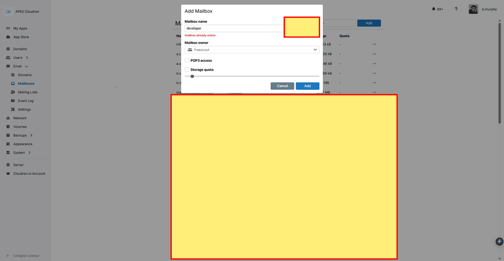

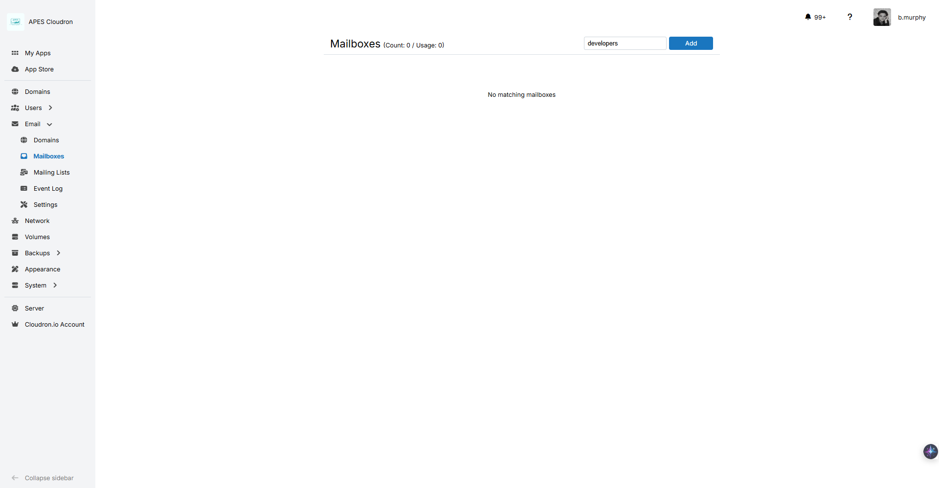

    I am trying to add a mailbox, but it says it already exsists but when I search the mailbox, nothing shows.
      Maybe there is a Mailing List of the same name? (The error message is still misleading).

        No mailing lists at all. Another strange thing is I can add them as an alias without error.

                  Yes it is showing there, for somereason just not showing on the GUI
