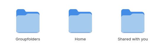

          Something changed as it used to work two weeks ago.
            I did sync a folder tree here with rclone also just fine, but I think maybe the issue is actually that cubby now has one extra folder structure in webdav. It used to only expose the users's home folder, but now Home is one folder next to Groupfolder and Shares. I can see that for example MKCOL /webdav/kdj/Literatur/ does not have /webdav/home/.... so maybe just the rclone config needs to be adjusted?

              @nebulon Thanks - such information are quite material and should be mentioned in the docs / changelog?
              However, when I click von WebDAV in Cubby, it still shows me https://cubby.domain.tld/webdav/user/... You say it's supposed to be https://cubby.domain.tld/webdav/home/user/?

                Now I get it: Instead of
                SYNC_PAIRS=(
                    "/Users/userLiteratur/:Literatur"
                in the rclone script, it's now
                SYNC_PAIRS=(
                    "/Users/userLiteratur/:home/Literatur"
                (notice the extra home)
                  yeah forgot to mention that in the changelog, given the low feedback on the webdav integration, I didn't expect it to be used much at all. So the previous version had a longstanding bug essentially where only the user's home was exposed via webdav but not group folders nor shared items. This was the fix to introduce new toplevel items:
