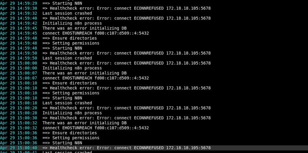

    Hi everyone,
    just tried installing a new n8n instance. in the logs is see the following error:
    "There was an error initializing DB"
    this loop continues until timeout. Tis is with version 4.20.0 I have no idea what to do next.

          Hello @bedrijfstak14
          Can you check the logs of the PostgreSQL service if there is any error logged?

            Hi @james,
            I have checked the logs and cannot find any thing weird. Al events are normal or where because of a restart of the service.

              Hi @james,
              Thanks for your help. This morning i woke up to the problem you mentioned https://forum.cloudron.io/topic/15442/ubuntu-24.04-kernel-6.8.0-110-regression-affecting-cloudron. After running the fixes mentioned in the other post.
              n8n was able to install. why this did work i have no clue. But the problem is resolved now.
