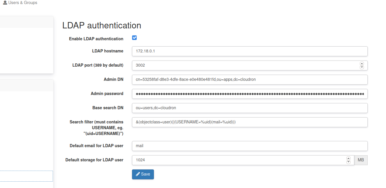

        LDAP for my teddy application is failing any ideas at to why these results might not work?
        nebulonN 1 Reply Last reply
          @ultraviolet these do look correct, only thing I could spot is the uppercase USERNAME however I think LDAP filters are not case sensitive anyways.
          Can you see any log message at all, like the admin bind or any search?
          ultravioletU 1 Reply Last reply

            @nebulon took a bit of digging but yes there is something:
            The filter &(objectclass=user)(|(adminldap=%uid)(adminldap=%uid))) is invalid.
            Which is weird. LDAP search strings are not my strong point
            • ultravioletU ultraviolet

              @ultraviolet fixed it missed a ( at the start of the string:
                @ultraviolet good catch! so it works now?
