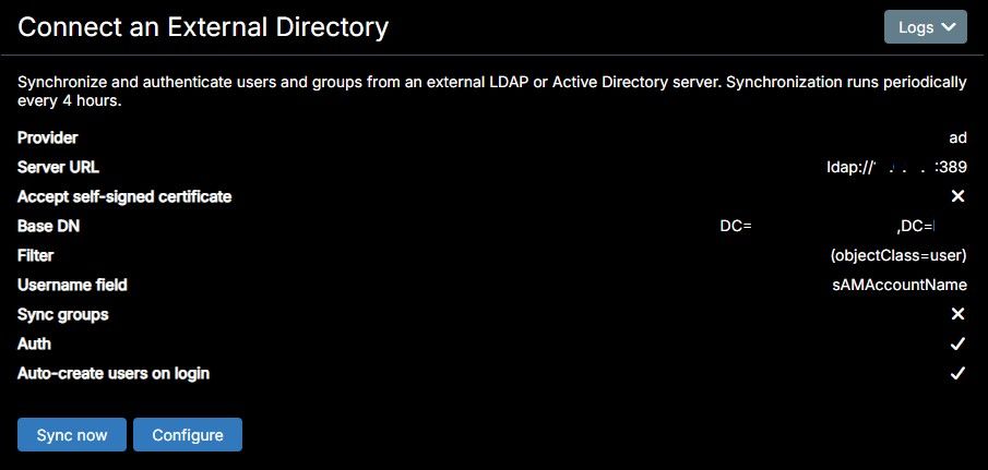

                            Hey guys,
                            Was wondering if we could potentially revisit this topic? I'm having a weird problem where my guacamole server is defaulting to mysql authentication even after getting my LDAP config setup and syncing
                            I've been able to successfully test a login using an AD account from my environment.... however when trying to authenticate with guacamole, it keeps failing and showing a denial from mysql authentication
                            Can anyone help?

                                    Hey James,
                                    Sorry been a bit busy here - but per your comment I can def share some insights. I went into the main cloudron dashboard, and navigated to Users > LDAP to configure my internal AD config (Dashed out some sensitive info for security)
                                    After the data began syncing properly, I manually went into my container and adjusted the authentication protocol to utilize OpenID instead of MySQL auth by adding the highlighted entity -
                                    All seems to be working out, outside of the one tidbit I mentioned previously. But it's manageable for now and my users are having no issues logging in and accessing resources using their AD credentials
