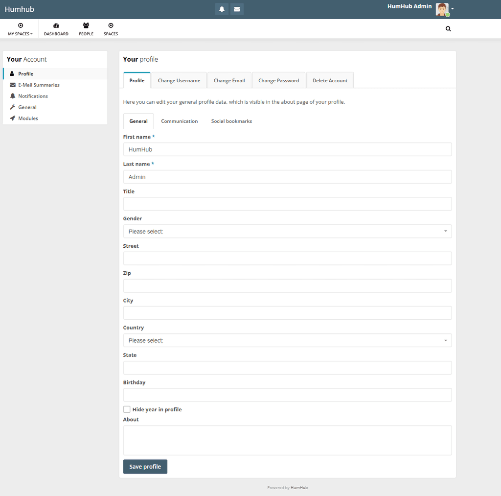

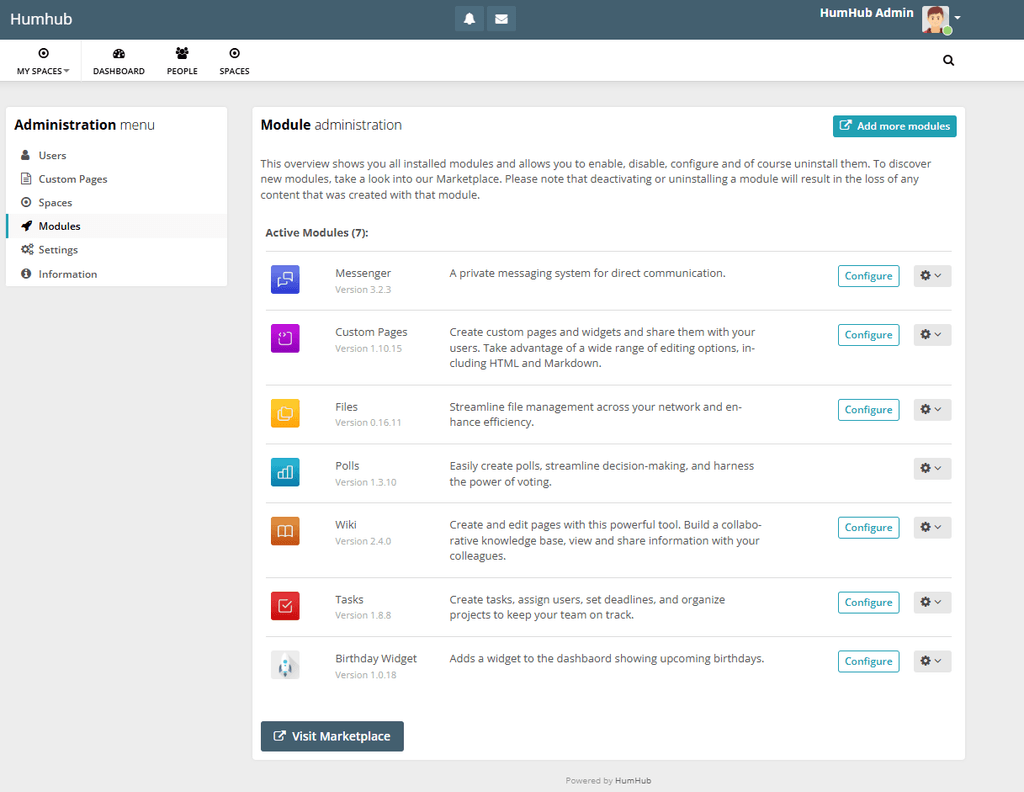

        • jamesJ Online
          jamesJ Online
          Hello @apesorguk
          What version of the Humhub app did you test on what Cloudron version?
          I have just tested this on the https://my.demo.cloudron.io server and have the fields and modules:
          But I noticed something that might could lead to such issues.
          The first startup comes up as "healthy" / "running" to fast. The app was still setting up the modules and such, but the dashboard displayed "running" already.
          Maybe, when interacting / interrupting Humhub in this semi done state, this might cause some of the issues you mentioned above.
