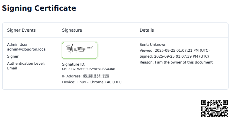

                • vladimir.dV
                  vladimir.dV
                  vladimir.d
                  #22
                  Hi @gdeflaux, I've installed a fresh app, uploaded a pdf file, set a signing form, then signed it. The completed pdf contains Signing Certificate page.
                  Could you elaborate step by step how to reproduce the issue you are facing with?
                  Could you try to increase memory allocated for the app in Resources section in the app's configure view and use the slider to set the memory limit and then to try to sign a pdf?

                      #24
                      @andirahmat How big a document were you trying to sign? Could you try to sign a small pdf just with one page?
                      I've tried to reproduce the issue but had no luck.
                      First I installed v1.7.0, the signing certificate page was succesfully generated there, then I updated the app to v1.7.1, and signed a new document - Signing certificate page was attached as well.
