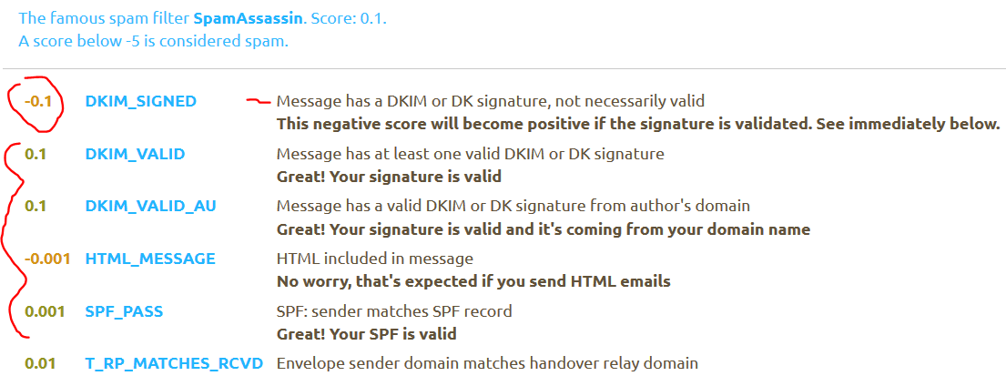

    I also used https://www.mail-tester.com/
    I ran the test three times. The first test email did not fair well. It "would not have seen the light of day" with a score of .8 out of 10. The email did not have a subject or contents. The second email where I included a subject and a little paragraph of text got 10.10 The thrid test, I used a little more text- it also got a 10/10
    But there were some flags consistent among the second and third tests:

      mail-tester
      mail-tester runs your email via SpamAssassin. So make sure you send email to it with some real text! If you send fake text or empty emails, it will correctly mark your email as spam. I will put this note in our docs as well.
