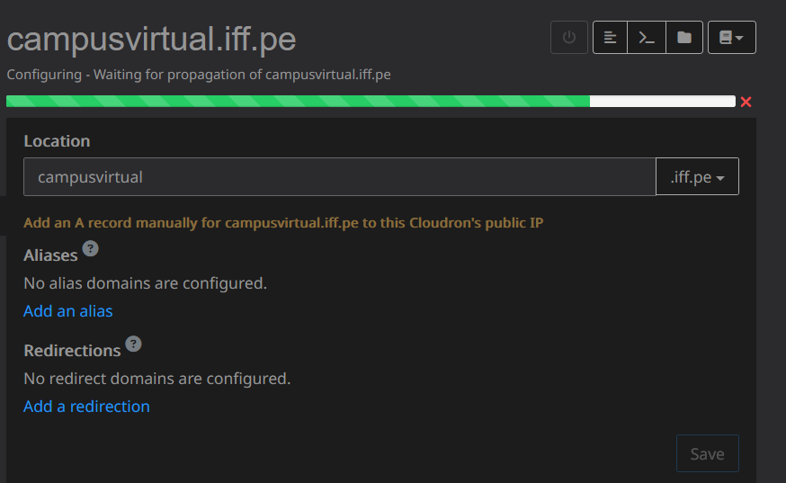

          • alejandrolenguaA
            alejandrolenguaA
            alejandrolengua
            I did change the domain of the application, but now it is showing as busy (Configuring - Waiting for propagation of the domain)
            • alejandrolenguaA alejandrolengua
              Super Fan
              @alejandrolengua have you already created the A record as instructed? If so it's probably just a matter of waiting for propagation like it says. Can be really quick, can take hours (or technically even days but that's pretty rare)
