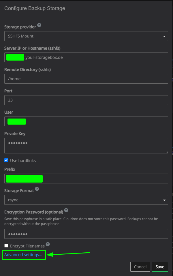

        • P Offline
          P Offline
          pitadavespa
