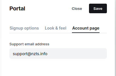

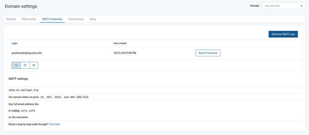

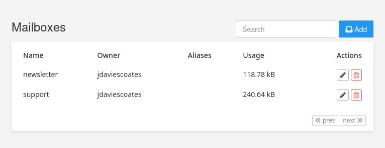

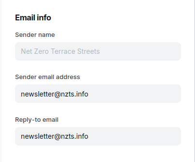

        @bmann said in Mail problems on Ghost:
        there is no "support" email address anymore
        I do still have this in /ghost/#/settings/portal/edit in my most recent Ghost install (installed last October)
        In addition to this in /ghost/#/settings/newsletters/xxxxxxxx
        And both of those mailboxes set-up on Cloudron:
        But just because it's the only thing you haven't mentioned (and it's caught me out a few times before) my guess is: perhaps you haven't whitelisted the IP of the server this Ghost is on over on Mailgun? 🤷
        See https://app.mailgun.com/settings/ip-access-management
        I just looked at my Mailgun SMTP settings too. Seems I've not edited those and they are just the default settings:
        bmannB 1 Reply Last reply
