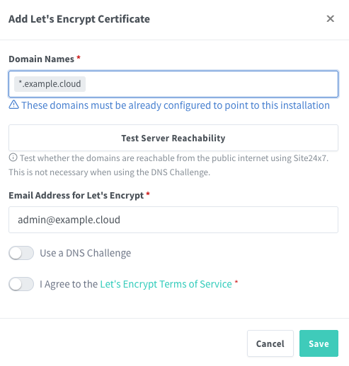

                  First setup a SSL cerificate for *.example.cloud by visiting the SSL Certificate Tab → Let's Encrypt Certificate. DNS challange option can be utilised here for automated validation without needing to open port 80. Instructions will be shown when the slider's enabled.

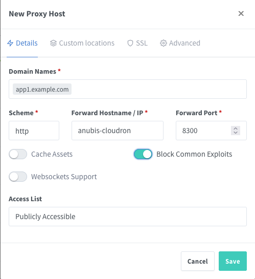

                  Add a Proxy Host for app1.example.cloud. Set the scheme as http and point at the Anubis container (anubis-cloudron:8300 if above docker compose file was followed).

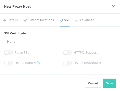

                  Next click SSL and select the certificate created in the previous step. Then enable Force SSL and HTTP/2 Support. Both HSTS options can also be enabled here based on the application being proxied.

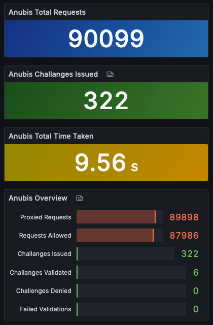

                  A Prometheus docker container can be deployed which can be used with Anubis Metrics Port (10000 in above docker compose) to monitor the Anubis instance with Grafana to output data similar to this.
