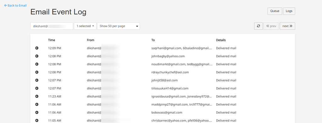

    Hello,
    I'm frequently facing an issue of email spoofing, basically someone spammer or hacker, gets into any of my users' email accounts and starts sending bulk emails to users.
    I'm not sure how this is getting into even though I changed the password of the email account; still, the spammer gets into the account and sends spam to users.
    Is there any way to find out what's causing this infiltration and how the spammer is getting into the system?
    Please let me know and guide me on this.
    Thanks!

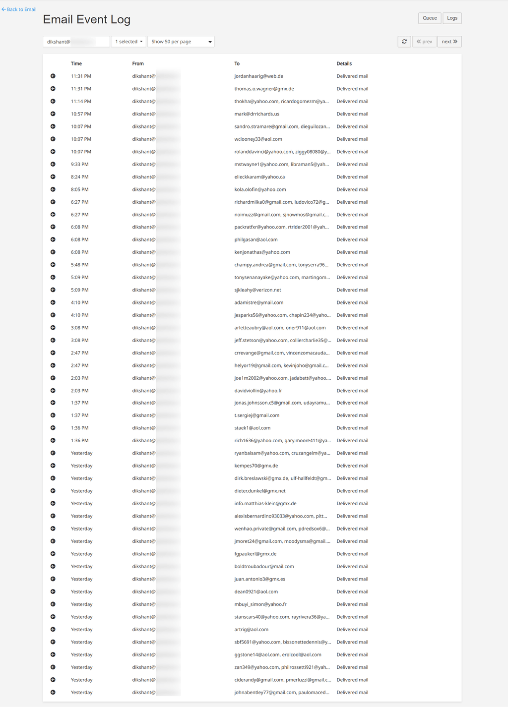

        I'm not sure from where these emails are going.. for the time being I need to deactivate the email account to stop the SPAM. Attached screenshot of the event log.

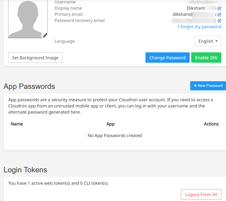

            The basic question is: did you change your Cloudron account password? Did you sometimes have a generated application password, e.g., for your email application?
            In my opinion, this looks like the password for the email application assigned to the Cloudron account has been compromised.

                  We changed the password multiple times.. but still the same.. the emails are being delivered to unknown users and even we don't know what exactly is being sent in the email..
                  This is urgent and I need a resolution for the same.

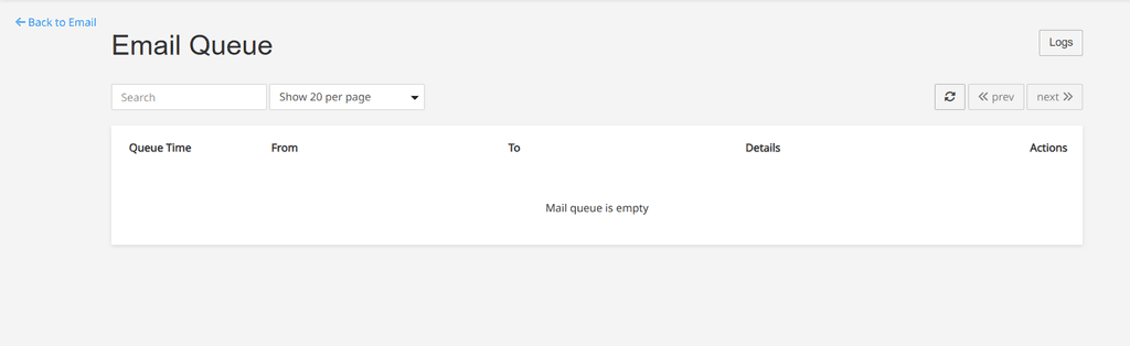

                              Please also post the log entry for queued for delivery for this email, remembering to also obfuscate any sensitive information such as hostnames.
                              • W Offline
                                W Offline
                                webliska
                                My Email Queue seems empty.

                                    @matix131997 Direction outbound just means mail leaving the server but the origin can still be the server itself. This is why we also need to see the second log entry. In either case the sender has access to the account and there is a good chance your app password theory is correct.
                                    @webliska Not the mail queue, the queued for delivery log entry for the mail you already posted. Each successfully sent email should have two log entries: queued and delivered. You might need to change the display filters if you only see delivered.
                                    Also check whether an app password is set for the mail user in question and delete it if it is.
