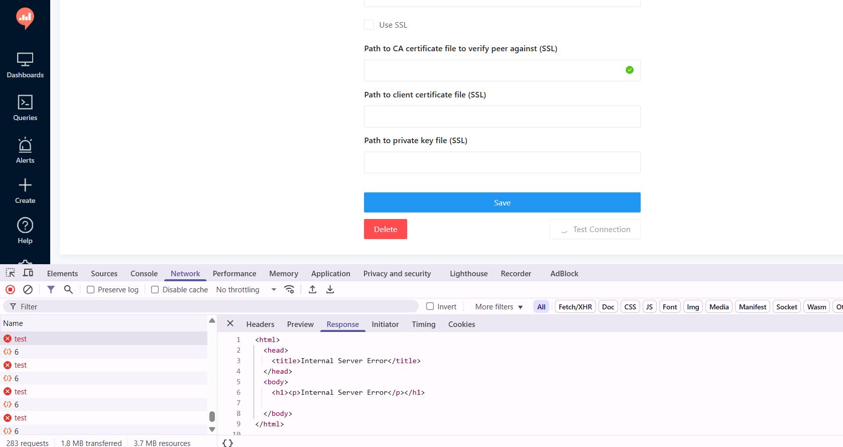

    I tried to connect my Azure Database for MySQL flexible server in Redash but it's not getting connected.
    I get an Internal Server Error when I try to Test Connection:
    Any help is appreciated.
