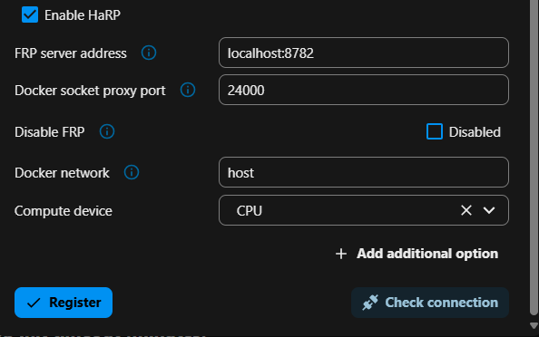

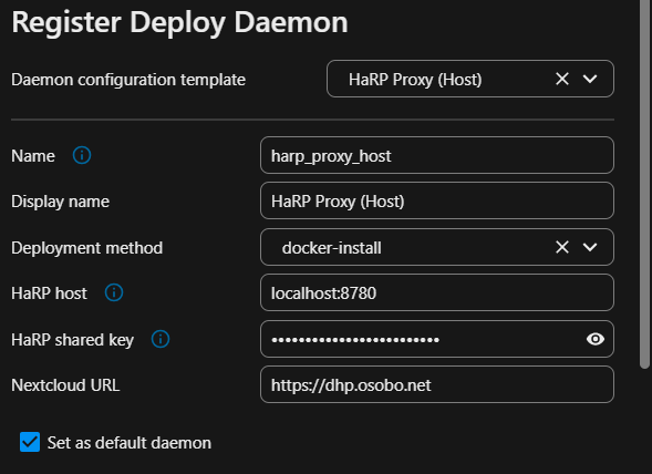

        Hello everyone,
        Following Nextcloud latest package update to 32.0.0 [5.6.0] it seems I've lost the ability to connect to the Nextcloud app store to update and install apps (?).
        I understand that Nextcloud requires for now to setup the AppAPI app in order to register a default Deploy Deamon. The how-to is mentioned here
        https://docs.nextcloud.com/server/latest/admin_manual/exapps_management/AppAPIAndExternalApps.html#setup-deploy-daemon
        Could someone please explain how to register this default deploy daemon to work with Cloudron ? There are many templates to choose from and I've no idea which one to use and the settings to input. I just wish to use the regular app store as before for browsing and update apps.
        Thanks a lot for your support and best wishes
        Osobo
