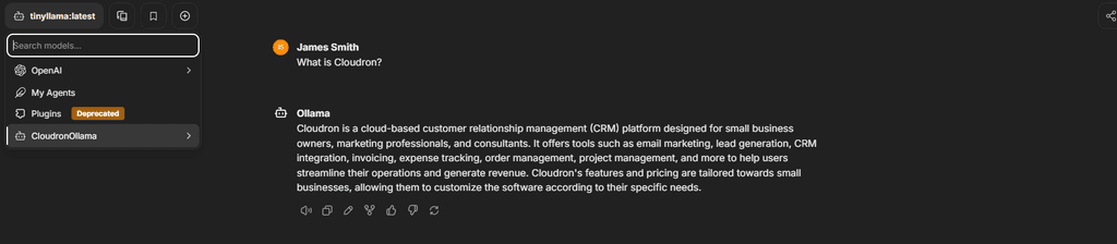

                      Tested this, config:
                      version: 1.2.8
                      endpoints:
                        custom:
                          - name: "CloudronOllama"
                            apiKey: "ollama"
                            baseURL: "https://ollama-api.cloudron.dev/v1/"
                            models:
                              default: ["tinyllama:latest"]
                              fetch: true
                            titleConvo: true
                            titleModel: "current_model"
                            summarize: false
                            summaryModel: "current_model"
                            forcePrompt: false
                            modelDisplayLabel: "Ollama"
                            headers:
                              Content-Type: "application/json"
                              Authorization: "Bearer eyJhbGciOiJIUzI1NiIsInR5cCI6IkpXVCJ9.eyJzdWIiOiJhZG1pbiIsImlhdCI6MTc2MTgxNjM1OSwiZXhwIjoxNzYxODE5OTU5fQ.YLZtAuIjqnApthTBfuoPyyyJ5a7N2wywn2GW9dTqUeU"
                      And indeed, this worked! But danny-avila already created a PR to fix this issue.
                      So, to get it working right now, just change - name: "Ollama" to e.g. - name: "CloudronOllama"
