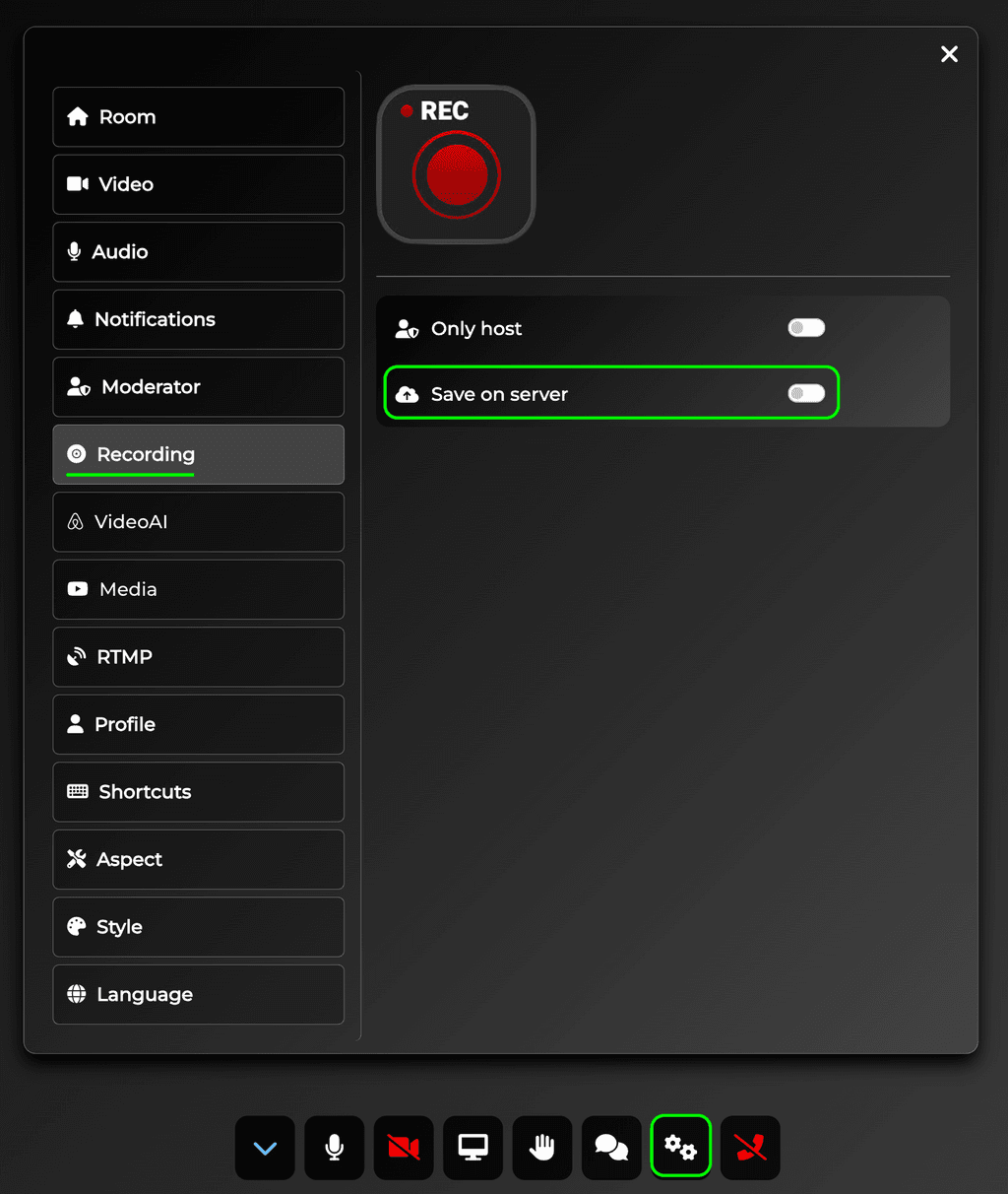

          MiroTalk SFU – Recording Options
          MiroTalk SFU offers 4 ways to record sessions:
          1. Client-Side Recording (Default)
          • Recording happens in the browser.
          • Stored temporarily in a Blob.
          • Once the session ends, the recording can be saved locally by the user.
          2. Server-Side Recording (Local Storage)
          • Recording is saved directly to the server at app/rec/.
          • Enable it by setting in your .env:
          RECORDING_ENABLED=true
          Note:
          If using Docker, make sure to mount the volume and ensure the directory exists:
          volumes:
            - ./app/rec:/src/app/rec

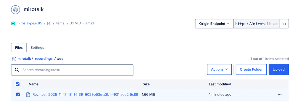

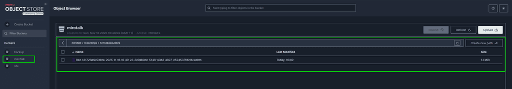

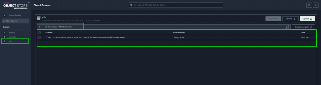

          3. Upload Recording to AWS S3
          • Recordings can be automatically uploaded to an AWS S3 bucket.
          • Enable S3 upload in your .env:
          RECORDING_UPLOAD_TO_S3=true
          • S3 Configuration:
          AWS_S3_ENABLED=true                  # Enable AWS S3 storage (true|false)
          AWS_S3_BUCKET_NAME=mirotalk          # Name of your existing S3 bucket
          AWS_ACCESS_KEY_ID=                   # AWS Access Key ID (optional if using IAM roles)
          AWS_SECRET_ACCESS_KEY=               # AWS Secret Access Key (optional if using IAM roles)
          AWS_REGION=                          # AWS region (e.g., us-east-2, eu-west-2)
          4. Custom Endpoint for Recording Sync
          • You can send recordings to a custom endpoint of your choice.
          • Configure in .env:
          RECORDING_ENDPOINT=http://localhost:8080
          Check out: https://github.com/miroslavpejic85/mirotalksfu/tree/main/cloud
