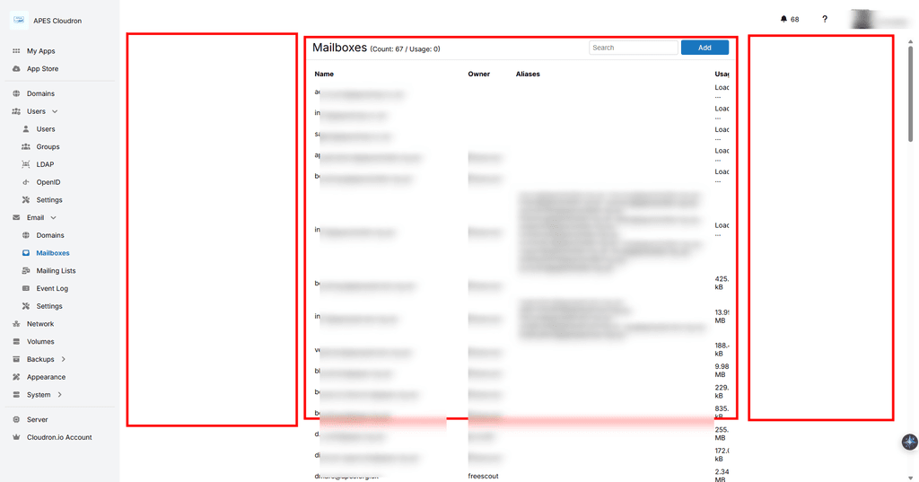

                    • apesorgukA Offline
                      apesorgukA Offline
                      apesorguk
                      wrote last edited by apesorguk
                      @girish One other thing
                      Seeing the menu to edit mailboxes is hidden as the list doesn't utilise the full screen. I thought this was an error at first, until I scrolled all the way to he bottom. The scroller doesn't show until reaching the bottom of the page.
                      It is a pain to have to scroll down to move across to access the mailbox menu. Especially when deleting multiple mailboxes by domain. Although we found that using the left and right keys on the keyboard sometimes allowed for horizontal scrolling. But still a pain to have to move left and right to make sure you're deleting the correct mailbox or editing it.
                      It would be so much easier to read if the list utilised the full screen.
