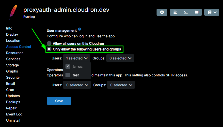

      But be we aware, all users in Cloudron, who are configured to have access to the app, either by all, user or group level, will be able to log in with proxyauth and then access the user creation of your custom software.
      Which you could limit like this for the https://proxyauth-admin.cloudron.dev/ app:
      This way, only the user james can see the app in the Cloudron Dashboard and is the only one able to authenticate in the /admin path.

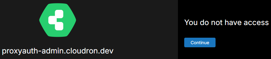

      So if I try to access /admin and authenticate with the test user I get:
