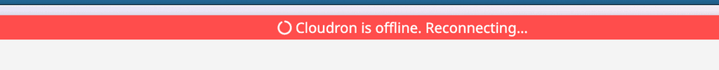

    The dashboard has recently become inaccessible, but all apps (e. g. NodeBB) works without problems.
    Steps to reproduce
    Several reboots, no changes in the behaviour
