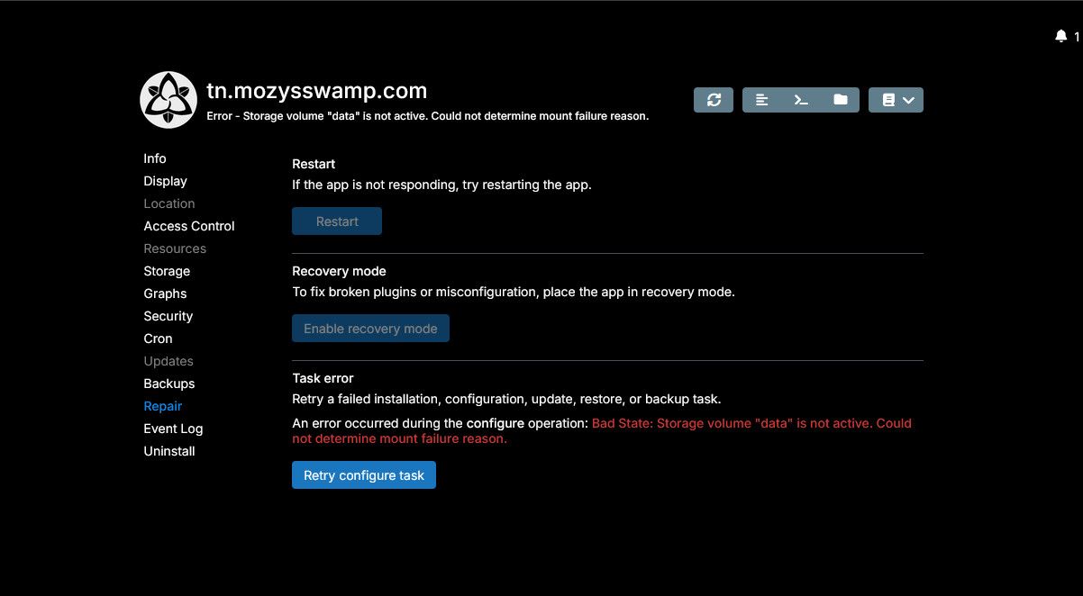

    Hi All
    OK think this has been happen for some timle

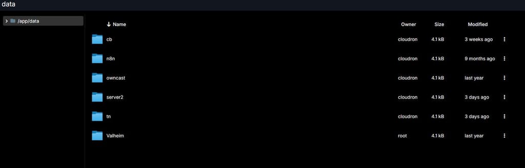

    have 2 disk and as you can see I can see the files on the 2nd disk from the UI
    same disk and is ok

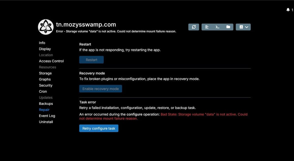

    but my TriliumNext server will not start ( see error )
    disk say it not mount but I can see the folder and a remount does not help
    this is the same as the error was going some time back look like it not start think the disk is offline...

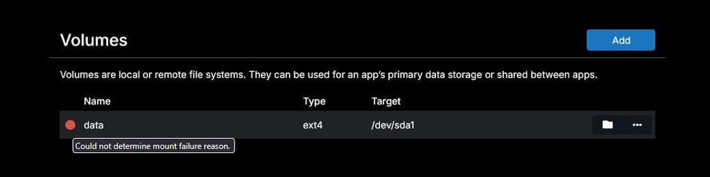

      @nozy Does remount work? It's in the "..." menu . Maybe timing issue with mounting? Can you give us more information about that ext4 volume? External disk attached via usb? Cloud storage disk?
      • N
        N
        Nozy
        I try a remount does not help all good but this one that does not come on line.....
        disk is ext4 and is on the same server disk ( hyperv )
        can see the disk OS does not have it mounted but I guess the dooker has it mount

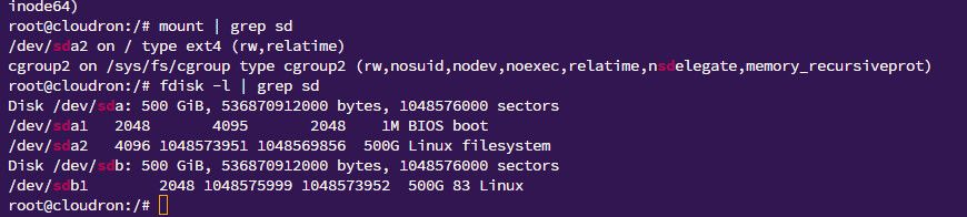

          hang on think I can see why /dev/sda2 on / type ext4 (rw,relatime) is the OS dik
          /dev/sdb1 has the be the 2nd disk sure missing something I can access the file system and the OS does have it mounted ?
          • J
            @nozy did I understand correctly that /dev/sda has the Cloudron install and /dev/sdb is your data disk? you have to re-setup the volume to use /dev/sdb1 instead of /dev/sda1 .

              thanks... I back it up 1st then remove and re add it

                can I update the config on the each to the right one ? ( can't remove the old one locked ) can't change the app or restore from a backup and still wishing to put it back
                • J
                  You can only change the credentials of volumes. Config (for example, mount type) cannot be changed.

                    If I can't change it or remove them
                    .... guess have to do a file system mount with FSTAB
                      Hello @nozy
                      Please be aware that the ext4 volume option mounts the disk itself, so no need for a custom fstab entry.
                      If you want to manage that yourself in fstab, you should use Filesystem (mountpoint).
