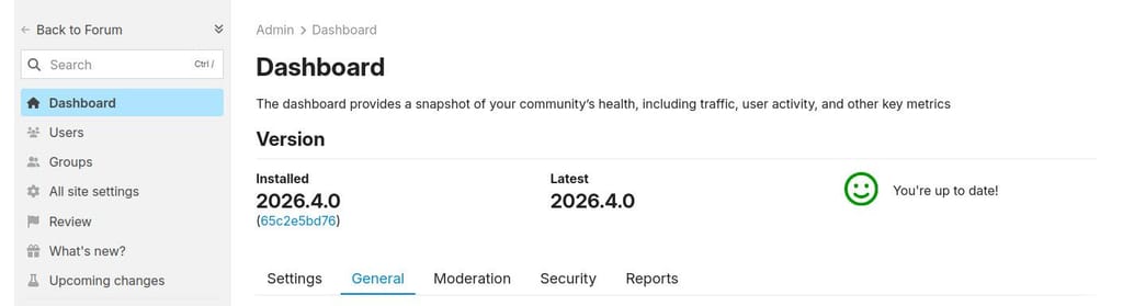

      The admin dashboard on our instance indicates "Translation missing: en.dashboard.problem.sidekiq_check" maybe corroborating the findings.
