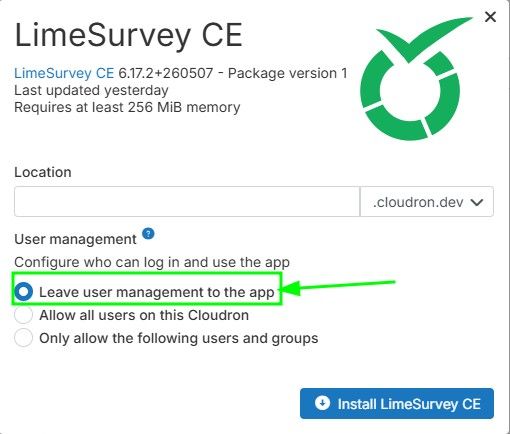

        Hello @patmo.de
        Please write topics in English to include everyone.
        In order to disable LDAP completely for @limesurvey you need to install the @limesurvey app with its own user management.
        Otherwise, when Allow all users on this Cloudron is selected, every app restart will configure and active the LDAP plugin again.
        I understand that you already have a @limesurvey app installed.
        To migrate your @limesurvey app to the Leave user management to the app version you need to follow some steps:
        • create a backup of your current @limesurvey app
        • download the backup configuration
        • install a new @limesurvey app and chose Leave user management to the app
        • when the new app is fully installed go into the backup Backups settings of the new @limesurvey app and press Import Backup and then click upload a Backup Config to upload your previous downloaded config
        • press Import
        • the app then restores from your backup
        • confirm everything is working in order
        • you are done

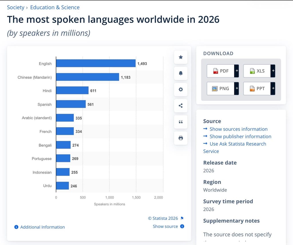

            @Patmo.de said:
            Please note that whilst English has a wider user base, it does not include everyone.
            Well… it includes more than any other language.
            https://www.statista.com/statistics/266808/the-most-spoken-languages-worldwide/
            It is the de facto world language. And it is the „Treppenwitz“ of the EU that its de facto common tongue is from a country that has exited… 🙂
