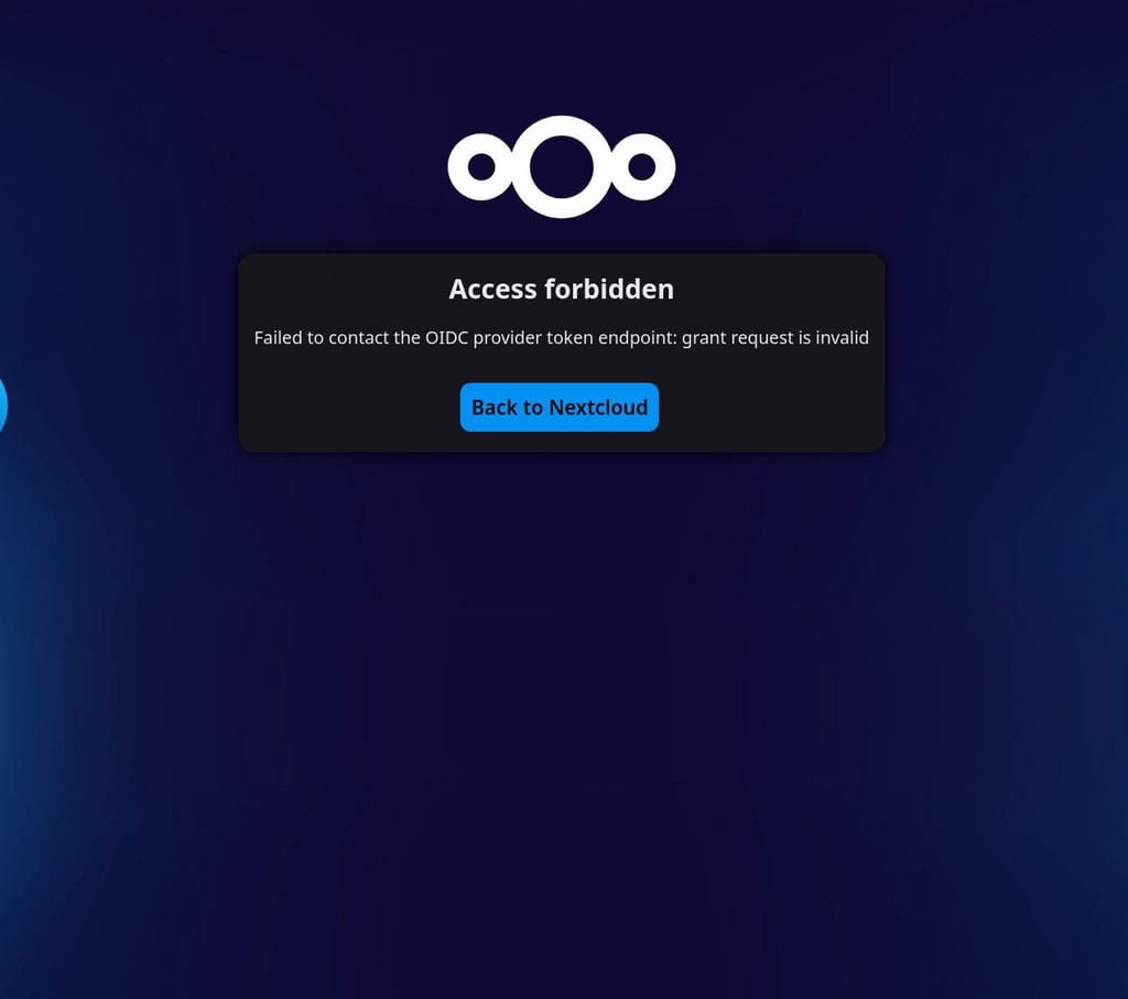

    Since this morning, on one of my instance (which has 3 nextclouds), I cannot access any of them where when trying get in normally (clicking on the app or going to the url) I'm getting this:
    The last thing that happened on that server is the update to Cloudron 9.2, yet on another server, also upgrade to 9.2, it works just fine.

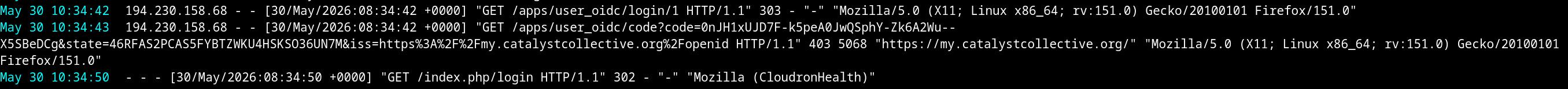

    Here is what I see in the log of a broken instance when trying to log in:
    Any clues?
