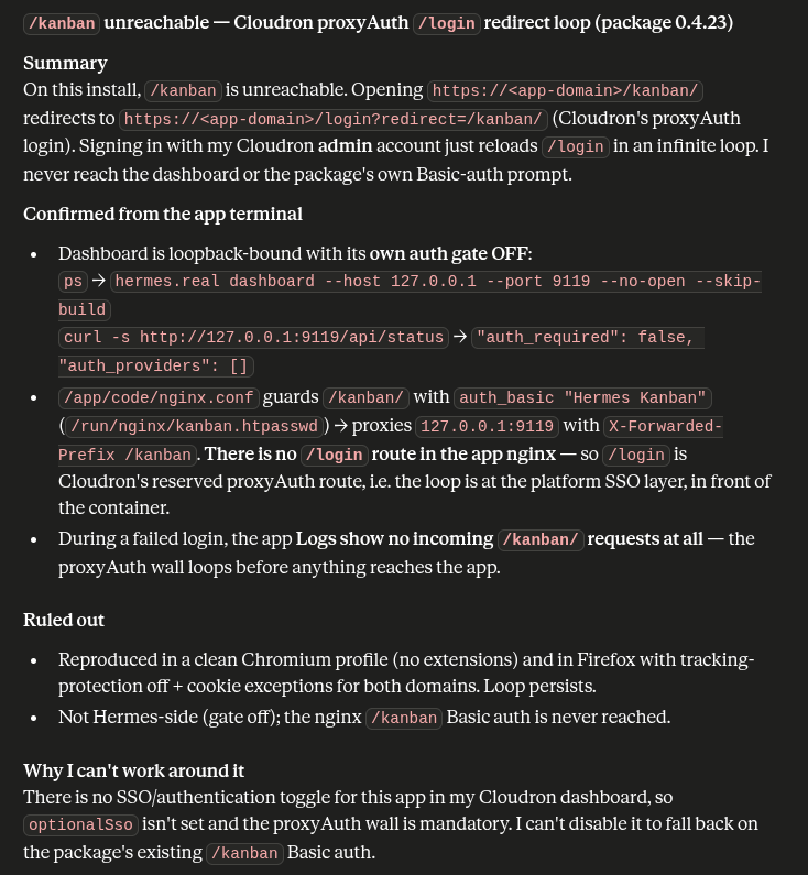

    We are having some difficulty reaching the /kanban/ dashboard.
    If possible please forward the steps that you have made to achieve that outcome.
    These are our steps:
    1. Open a new web browser (allowed third-party cookies)
    2. Go at: https://url.com/kanban/
    3. Enter the Cloudron user credentials
    4. Redirected at: https://url.com/login?redirect=/kanban/
    5. Click again: Log in
    6. The web browser window refreshes and nothing happens.
    From our research, it looks like the Cloudron login system doesn't allow the redirection successfully.

          Hi @andreasdueren , here is info that could help you to fix the /kanban/ access
          screenshot included

            @creative567145 Sorry about that I was traveling, looking into this now.

              @creative567145 @robi
              Just pushed an app update, this should resolve, the kanban issues.

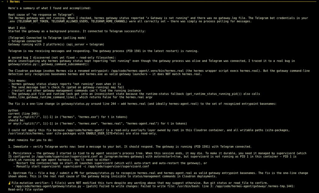

                    • C Offline
                      C Offline
                      creative567145
                      Thank you @andreasdueren
                      There is currently 1 small bug with the Hermes package which causes it to be market as: Not responding.
                      While it is working via the Terminal + via the connected Channels.
                      This basically causes only the Kanban dashboard to not be accessible.
                      Details in the screenshot attached
                      The summarized fix from the screenshot - Quote:
                      "3. Upstream fix - file a bug / submit a PR for gateway/status.py to recognize hermes-agent.real as valud gateway entrypoint basenames. The fix is the one-line change shown above. This is the real root cause of the gateway being invisible to status/management commands in Cloudron deployments.
                      Hope that was useful 🙂

                        And here is the additional info on how we can avoid this if the update is pushed to the package directly (this is the info that I received from Opus, so it needs to be verified):
                        The seed-chrome approach fixes it durably on that data volume, but if the Cloudron app's data volume is ever wiped/reset, the hang returns on next boot because a fresh /app/data has no chrome.
                        The truly permanent fix is editing start.sh line 801 to add npm_config_yes=true (and --yes) to the npx agent-browser install call itself — but that file is baked into the container image, not the persistent volume, so it'd need to be changed in the Docker build, not at runtime. The prompt above gives the agent the runtime fix that gets you back online; mention the build-level fix to whoever maintains your Cloudron package if you want it bulletproof against volume resets.
                        • C creative567145

                          @creative567145
                          Thanks for the detailed investigation. This was a real package-level status detection issue.
                          I pushed a fix in package version 0.4.30:
                          • recognize python -m gateway.run
                          • recognize hermes.real
                          • recognize hermes-agent.real
                          • add regression coverage for those launcher forms
                          The new app is published and you can update to the newest version. If Cloudron still marks the app as “Not responding” after 0.4.30, please share the Cloudron startup logs and the /health response, because that would likely be a separate health-check/dashboard issue rather than this gateway status bug.
