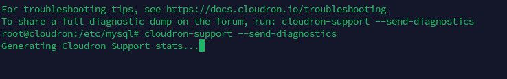

    Hello @nozy
    We did not receive a diagnostics report from your system.
    Please write a mail to support@cloudron.io.
    N Offline
    N Offline
    Nozy
    @james Hi James
    did not stop running I am rerun it now ....

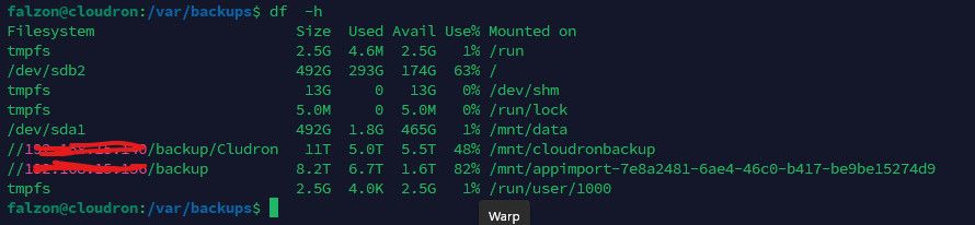

                Hello @nozy
                It also looks like your disk is at 88% usage.
                This could lead to mayor issues when the disk runs out of space.
                That could have been the issue when you updated the system, it ran out of space and MySQL could not write correctly.
                Do you need assistance to restore the box.mysqldump?
                Also, what did you update? The Ubuntu system or Cloudron?
                • N Offline
                  N Offline
                  Nozy
                  88 % still had over 62GB to go before it run out and I have a scrip that will email me drop under 10%

                      think it was not low space but may be time to add ( sure I can scrip or even take box offline by doing a stop )
                      at 5% space take the system offline or pause ( sure docker can pause )
                      hyper v does it if see low pause ( or email @ 10 % then pause at 5% )
                      think it time to re billed time let see how easy it is to move to a new VM under promox
                      look at the space had backup from 2022 in /var/backup remove that drop back down for 87% to 63%
                      thanks @james and @nebulon
