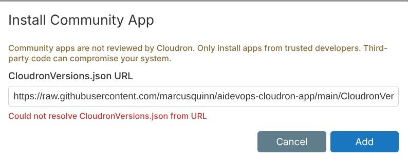

    @marcusquinn Any idea why the installation is failing?
      Hello @luckow
      I just tested and it is working for me.
      This might suggest a DNS issue on your end.
      Maybe you can check from one of your apps web terminals if you can curl/wget that file:
      # get status code from curl
      curl -s -o /dev/null -w "%{http_code}\n" https://raw.githubusercontent.com/marcusquinn/aidevops-cloudron-app/main/CloudronVersions.json
      200
      # DNS lookup
      dig A raw.githubusercontent.com +short
      185.199.109.133
      185.199.110.133
      185.199.111.133
      185.199.108.133

        200 & DNS lookup is working perfectly on the instance. I'll try it on another server.
        Same behavior on the other instance and also on the demo instance. Voodoo.

            @marcusquinn Don't waste any time on it. I've checked with team mates and everything's running smoothly for them. It's probably down to my local setup. I'm completely in the dark at the moment, hence the #voodoo label 😉

              @luckow no worries, it was good to do an audit on it anyway. it's likely a cloudron 9.2 vs 10 compatibility thing:
              • https://github.com/marcusquinn/aidevops-cloudron-app/pull/67
              just cutting a new release
              not sure if you've looked at the cloudron-buzz-app yet, but i can see that being great for teamwork — with the opencode agent connector — and a good partnership with aidevops
              just always keep a mind for security, as all this ai is a bit of a minefield for what it can do with what it can reach
              • luckowL luckow
                @luckow it's probably related to the ssrf update https://forum.cloudron.io/topic/15758/community-store-apps-added-after-today-s-ssrf-fix-never-appear-in-the-public-listing

                  @luckow new release now available - keep me posted how you get on
