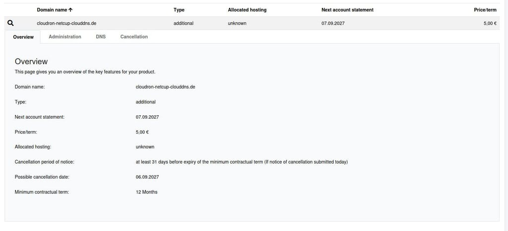

      @lukasp we have ordered a new domain at netcup to figure out how to use this new CloudDNS and what the new nameservers are. We didn't get any response from support so far.
      • girishG
        Even the new domain is on the old DNS afaict .
