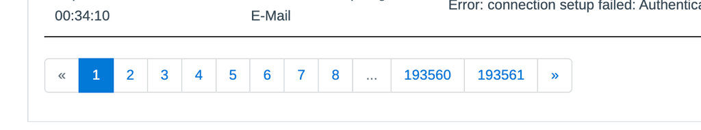

          I also thought about that. After some research I have found out that there is mailboxes / support boxes within FreeScout that try to connect to an IMAP / SMTP mailbox which no longer exists.
          Also I have noticed that the meiliseach instance is no longer there. It has been disabled but the respective entries in the config file have not been remove - although the module has been disabled. When I try to uninstall the module, the page reloads, but the module is still there. It does show a confirmation that the module has been deleted.
